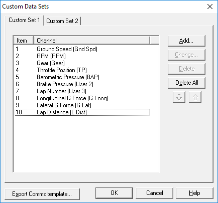

Trying to get the V2 to receive data from the M800 is my current issue. The instructions are somewhat vague on doing this.

You will need to send a Custom Data Set as a compound message out of the ECU. Below is an image of how to configure the custom data set.
M800 to v2 CAN Setup.png (8.62 KiB) Viewed 38364 times
Even if you don't have some of those channels you have to put something in as a place holder, so for instance if you don't have lap number, you have to put some channel in otherwise the two G-Force channels and lap distance won't work.
Re: V2 Video section?
Postby adrian on Wed Feb 01, 2017 10:04 pm
Something I forgot to mention is that the address needs to be set to 31.

Postby David Ferguson on Sat Feb 04, 2017 3:27 pm
You select the value 7 (Custom Data Set 1 Compound) for CAN 0 Data.
If you used Custom Data Set2, then you have to set the value to 10 (Custom Set 2 Compound Tx) for CAN 1 Data.

Postby locash on Sun Feb 05, 2017 6:00 am
Unfortunately, I am using an SDL dash logger on Can0 data, so I guess I will have to use Can1 data and use custom set 2. Too many different CAN devices on this car I guess. I will give that a shot, and if that doesnt work out, I will try to connect it via my SDL dash I suppose..

Postby David Ferguson on Sun Feb 05, 2017 6:16 am
It would be much easier to setup the SDL to talk to the V2 Video. There is a template you can just load.

Postby locash on Sun Feb 05, 2017 10:13 am
I ended up connecting it to Can1 on the SDL3, although there was no v2 video template, I ended up using the VCS TransmitCompound full template and just setting constants for the channels I am not using..
