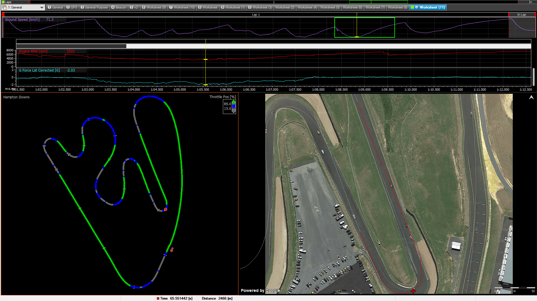

Here is what I mean.
Image of the entire lap and entire screen.
Lets say I want compare 2-3 laps on the last turn on the GPS maps (driving line)
when I zoom in to that turn, not only does the data (racing line disappear) but I am cornered to the bottom of the screen. I want to see the turn in the center of my screen up close ans see all the driven lines without them going away.
I understand why they are going away. But there way to be a way to just zoom in into the map independently of the data.
I hope this help.

The reason the corner is at the bottom of the screen is because you have a large portion of the straight selected as well. When you zoom in and out this is done in reference to the cursor position. In the screenshot I posted before you can see on the outing graph exactly where the GPS map is zoomed into. If you want to see just the corner, in a time/distance or outing graph select just the data you want to see and the GPS map will zoom to that
In i2 everything is linked to either the cursor position or the selected data range.

Postby FoxSTI on Mon Dec 05, 2016 4:28 pm
no, the corner is at the limit of the track and this is typical at all limits of the track regardless of zoom.

Postby adrian on Mon Dec 05, 2016 4:58 pm
Ok sorry, I though you were talking about the zoomed area showing more than just the corner you were interested in.
There has been a change to the way we display the GPS Track Map that will allow a 20m buffer at the extremes of the map. This will allow you to see the whole corner rather than having the drive line hard up against the edge of the GPS Track Map window. This change will be in the next release of i2.
