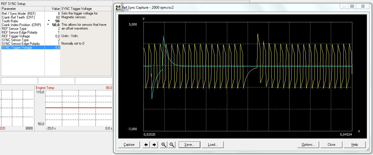

Hi all,
I have a lab setup with a M800 which is supplied with crank & cam pulses from a simulator that a friend of mine has built based on "some Arduino" (excuse me, I do not know more.... :) ).
It works fine, get RPM readings which means that I can test various AUX outputs.
BUT, it will not sync so I am not able to test ign & fuel outputs.
I have played around with various settings in REF/SYNC setup, but..... :|
A screen dump may perhaps give someone a clue of what is wrong (or if it is even possible to get it working....):
M800 2000rpm Arduino simulator.JPG (131.86 KiB) Viewed 15643 times
Any help is much appreciated :P

A partial screen dump of an incomplete 720 scope trace wont really help much...and then without knowing
Rising edge might be better for that sync, falling edge for the ref.

Thanks Stevie, tried your settings for REF/SYNC, but no difference - M800 diagnosis still says
Error Sync Signal
and
Ref/Sync SyncroniseNotSYNCED

Postby AlanB on Thu Aug 25, 2016 9:10 pm
Hello Christian
Try changing the Ref Sync Mode to 7 (not 8), use rising edge for the sync and set up the mag level tables correctly, in particular the sync table (currently set to 0.0V for some reason). The help for the mag level tables gives information on how to set them according to the signal levels.

Postby LOLA-Christian on Fri Aug 26, 2016 3:29 am
AlanB wrote:Hello Christian
Hi Allan,
many thanks - following your advice, it worked just fine.
Simulator has a max output of 10 000 rpm, no error up to that level.
/Christian
