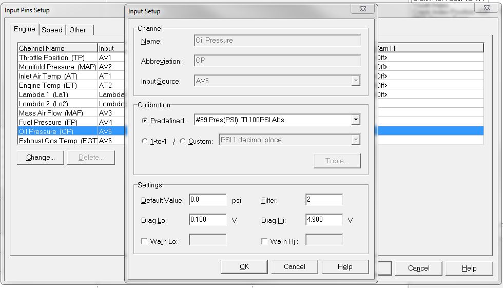

Hi
How do i change the units for oil pressure and fuel pressure etc being sent to dash by M84
Have a conversion issue with my C125

What units are you using in the ECU? The dash assumes everything is sent in SI units so if you have your pressure channels in PSI then you will need to either change it back to kPa in the ECU or convert it in the dash.

Units in Ecu are in PSI. Was wanting to know how to change them.

In the Input Setup page, you select the units used for the Input by selecting the appropriate calibration. This is shown in the brackets in the name as to which unit is used.
