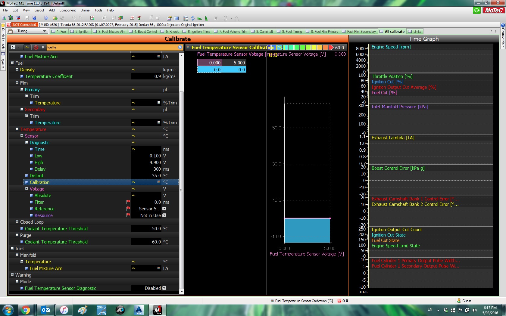

I was afraid someone would tell me that however from what I've found thus far it looks like I have resources other than just analogue temp available for use with the fuel temp.
Temp Sensor Screenshot.jpg (432.58 KiB) Viewed 23711 times
Temp sensor Resource.jpg (522.07 KiB) Viewed 23711 times

Yeah that package won't support it unless you edit it in Build which requires the development package for your ecu.
I could develop a partner package for you that would likely be a cheaper alternative. If you're interested email me at ben@carolinadyno.com

We are planning on having a Beta of Flex Fuel available at the end of the month for the M1, when this passes testing then it will be released as a general package available for all.

You've just made my day. Will we require anything other than an ethanol sensor to be added to the ecu?

Just the Ethanol sensor, we will have a calibration built in that covers the continental units.
