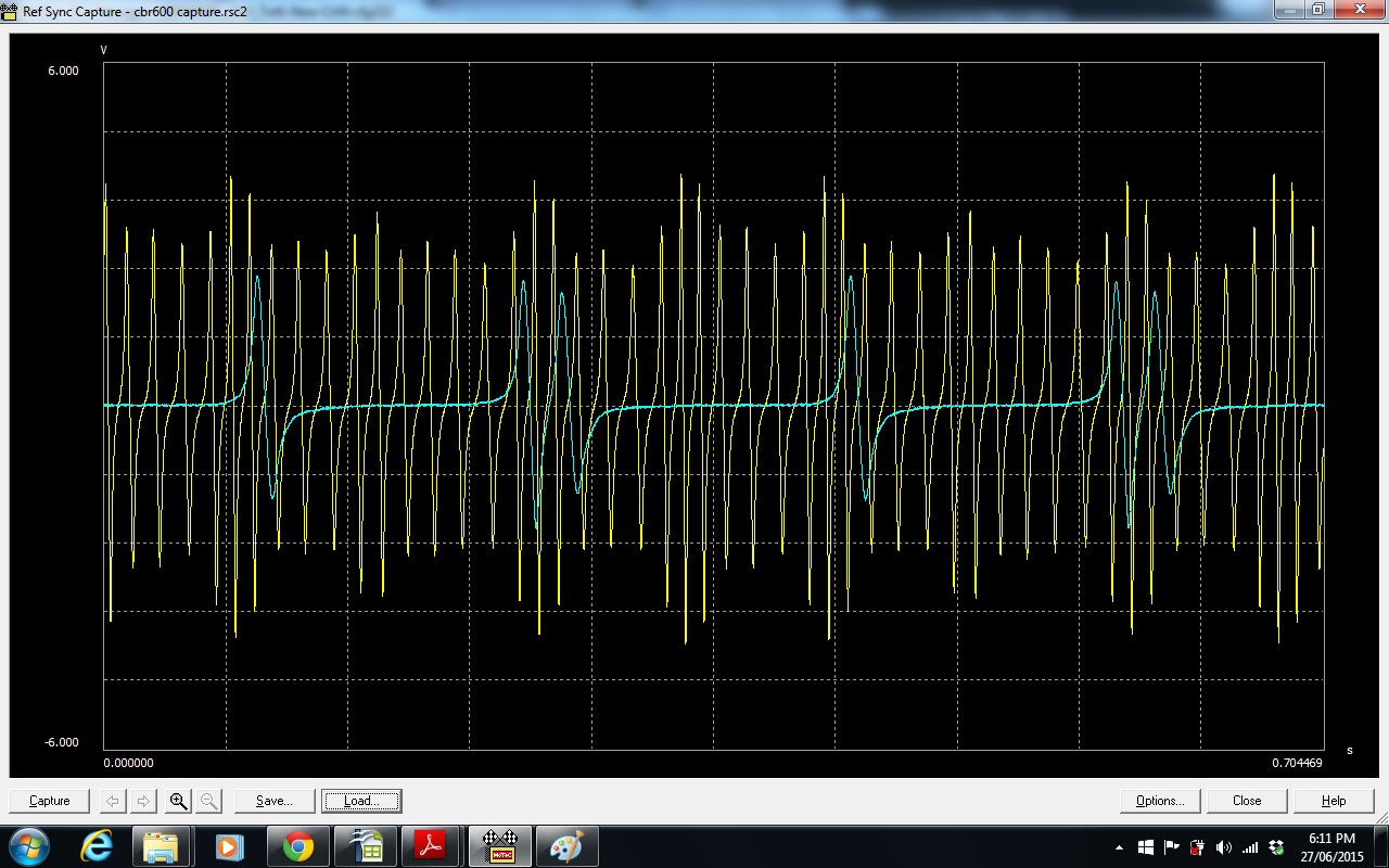

Some setup here was from a start file I got from a mate of a mate, also info on this forum. But really, can someone explain why I have mode 22 and what setup is behind that? F1 Help only says Ford Cosworth. If I had another engine with similar pickups, how would I decide on mode 22? Also, the method for getting the crip for startup is a guess, as there are 3 teeth on the cam. Which one gets to start the count? (Maybe it is half way between the 2, then the next Ref tooth is the index?)
I have sync, I have fuel and spark, I have fire! Out the intake... So timing is off.
The main reason is that for Motec the ignition and injectors are fired in numerical ascending order, not firing order! I didn't know this. I need to swap some pins around, should be good now.
But here is my capture anyhow. Why is the actual file type not allowed?
capture
CBR600 capture.jpg (281.4 KiB) Viewed 22987 times

Funny thing is, that capture above was done with B1 and B2 (ref and sync) wires around backwards, but the ref signal is still shown as green somehow. (I am at a uni and other students have done some of the wiring).
I have swapped the wires, B1 is ref, B2 is sync. Did another capture and it still looks the same.
I have to have sync polarity as falling, then I get sync and the fuel&spark are operated.
If I put sync polarity as rising, I get sync errors, and no fuel&spark when cranking.

Your ref sync setup looks correct, both edges should be falling based on the capture you uploaded and the CRIP of 431 is correct for a CBR600. The mode is also correct (mode 22), don't be concerned by the help indicating it is for a Cosworth.
