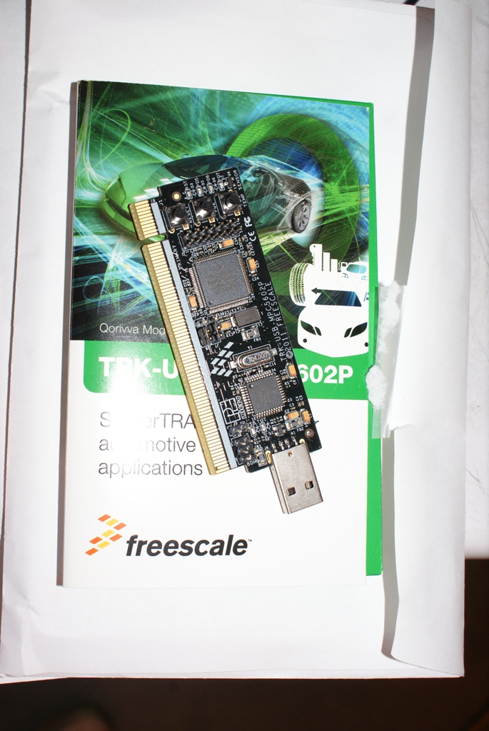

Postby mk e on Sun Apr 26, 2015 3:14 am
Still mad the M150 has 2 lambda pins it can't use for lambda.......a buddy said he's got some time to help out so I just got a couple of the TRK-UBS-MPC5602P boards to make a couple prototype AN to CAN units. They'll have calibration lookup tables on all the AN so it can read any NB sensor or WB controller and replace 8-12 LTC units (depending what connector we find) or send any other AN signal in for the pins challenged M130. If it works I'll have some run off and through them on ebay for anyone else who needs it....it shouldn't be more than $100. Problem solved.
