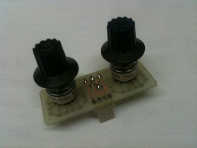

We added launch control, traction control (which is amazing), antilag and boost in gear which made the car so much more easy to drive. i made 2 9 position switches for boost and traction control.
