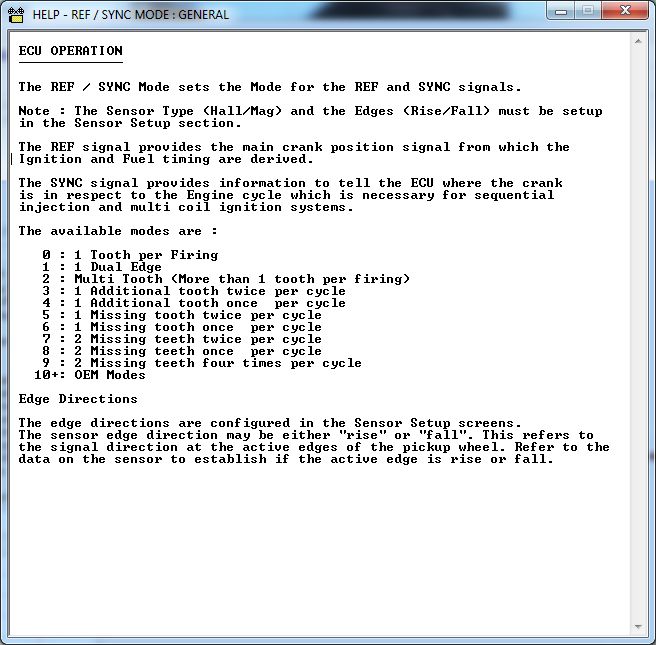

Scott@FP wrote:Notes for mode 28 ARE there. Keep scrolling. Hit 'OK' on '10+ OEM modes' as it scrolls down. The help F1 menus are pretty extensive, but sometimes not obvious.
It's not unfortunately, see the attachment of the screen capture.

Postby JulianEdgar on Wed Aug 13, 2014 8:45 pm
In the help menu, if you select OEM modes, you have several more screens of help - modes 10 - 69.
eg
28 : Toyota
Suits: 4ZZ FE, 3ZZ FE and other VVTi engines, ie. VVTi Yaris
(Echo), Corolla, etc.
Ref : 36-2, MAG, RISE : 36 evenly spaced teeth with two missing
(per rev)
Sync : 4-1, HALL (4ZZ FE), RISE : four evenly spaced teeth with
one missing (per cycle)
CRIP : typically 469

Postby Billzilla on Wed Aug 13, 2014 9:31 pm
JulianEdgar wrote:In the help menu, if you select OEM modes, you have several more screens of help - modes 10 - 69.
Weird .... that menu appears on the Motec software on my desktop computer, but not the laptop that I use on the car.
