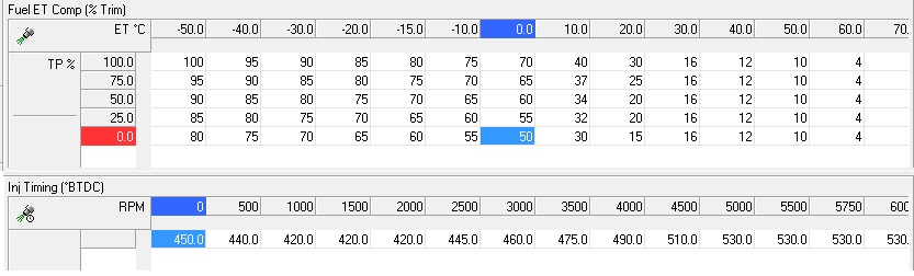

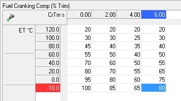

Postby scoobyman on Sun Mar 24, 2013 1:42 am
Ok, so after all the tips from you guys here is what i ended up with, I can say that its slightly better, i managed to start the car in -10c today, it took me about a minute cranking it on and off, but i did manage to start it!
Here are the tables that i now i have, is there anything else i should change to make it better ?

Re: Car refuses to start in cold conditions
Postby Holmz on Sun Mar 24, 2013 12:42 pm
What RPM does it idle at?
You may want a timing cell just below that...
(i.e. say it idles at 850 and cranks at 600)
e.g.
0 = 380 (so a bit before TDC for ease of cranking
500 = 380 (same as above)
550 = 450 (now put in more advance to start)
750 = 460 ( increase the advance to move the idle back up in RPM)
850 = 420 (Decrease the advance to move the idle lower in RPM)
1000 = 420 (into your map)
Fuel cranking comp
Have you tried making the fuel cranking comp that is "80" at -10C go to "100" at -10C ?
Fuel comp
Have you tried increasing the comp at -10C
e.g.
TP=0 / -10C = 75 (was 55)
< I would probably get it to crank/start and then look at the whether more fuel comp is needed at a lower temp - probably with before CAT lambda numbers >

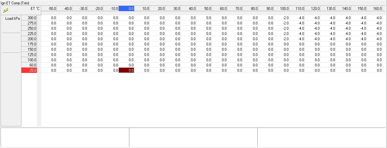

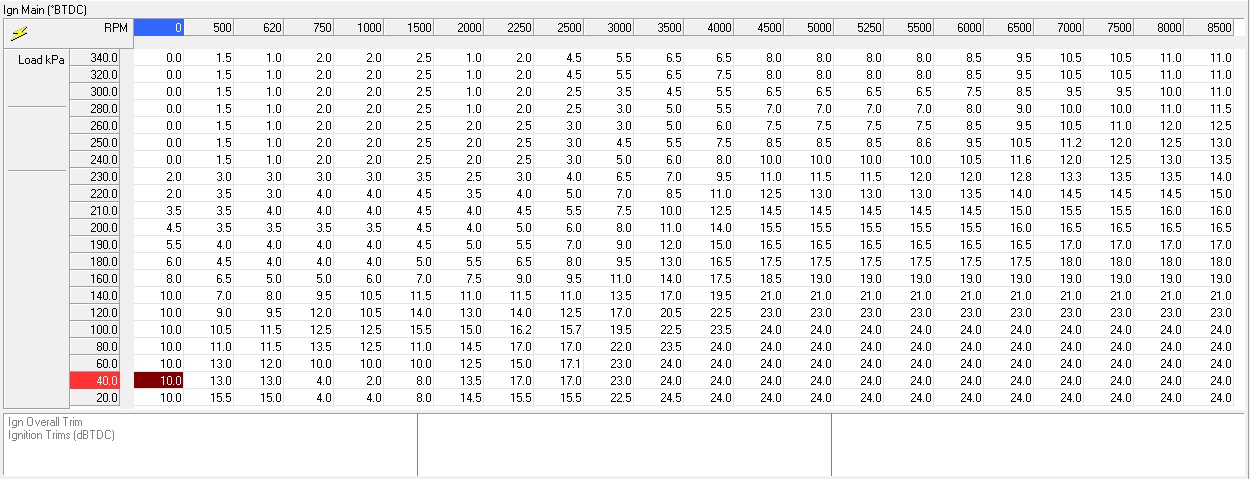

Postby scoobyman on Tue Mar 26, 2013 6:54 pm
Thanks Holmz,
Here are my current ignition tables, could you recommend any cold start changes i should make ? I have absolutely no idea what range of value changes are acceptable and which are not.

Postby Holmz on Tue Mar 26, 2013 8:30 pm
scoobyman wrote:Thanks Holmz,
Even better I found that the good chaps in Croyden South have moved the videos to youtube.
And then can be iPadded or iPhoned and used in the garage.
I would say start here: http://www.youtube.com/watch?v=H-zHSvZ7PSg&hd=1 as it is better to understand it, then to get the answer.
The whole list is here: http://www.motec.com.au/webinars/webinararchive/
But it would be nice to see what answer you get as well.
I would suspect that you need to see what the load value is (20, 40 , 60) which will require some logging to look at.
http://www.youtube.com/watch?v=aro9b4gnzps&hd=1
Assuming it is the 20 (which I really doubt) then the (10, 15.5, 14, 4,...) would probably need to go to (-5, 25, 14, 4,...)
By the way, where are you located? It seems we are on at the same time??
