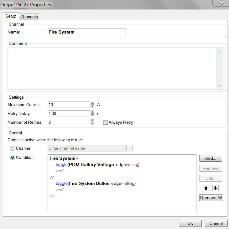

- pdmshot.JPG (65.51 KiB) Viewed 13303 times
I have a pdm 30 and we have a fire system that I want on once the pdm is on. (so anytime there is power)
I also have a momentary switch that i want to be able to push that will shut off the fire system while working on the car with power on.
I want the fire system to be on as a default though, Any help is appreciated.
