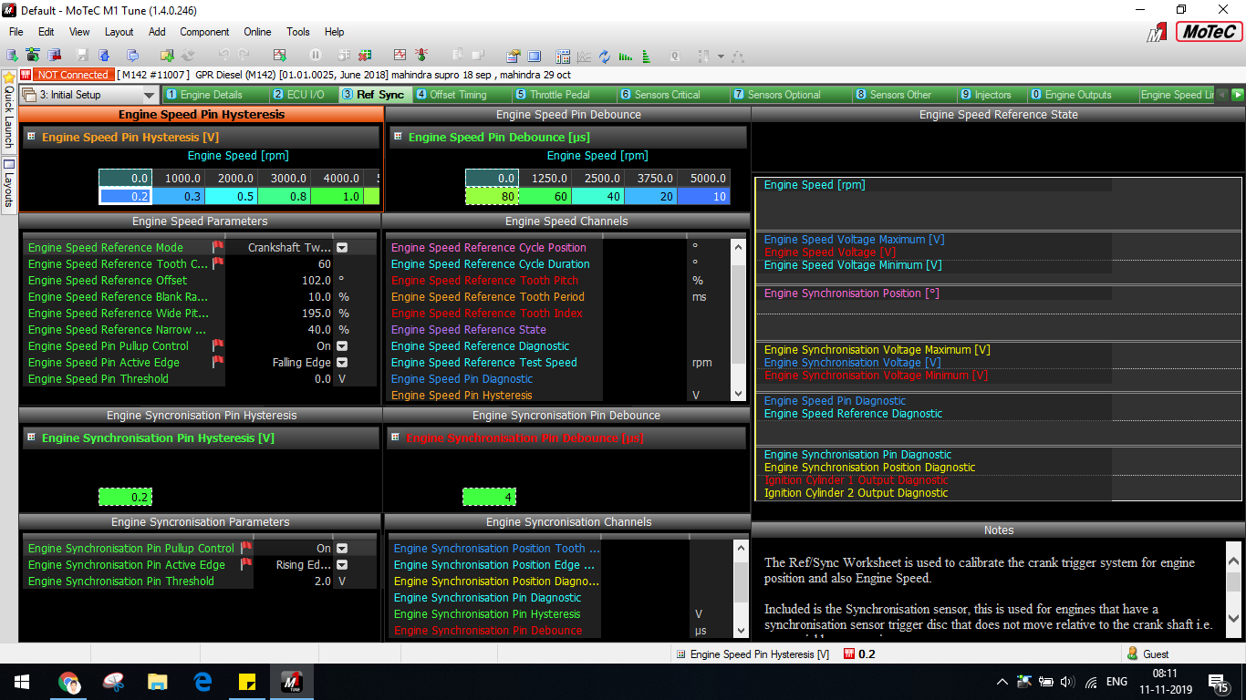

Postby vishnus on Mon Nov 11, 2019 1:47 pm
Hi David,
Thanks for your quick response. I am attaching ref/sync capture and parameter snap. Please suggest what is the main cause.
Thanks.

Re: Hard to hit cycle lock
Postby Stephen Dean on Mon Nov 11, 2019 4:17 pm
You have a Mag sensor for the Engine Speed Pin, so the Engine Speed Pin Pullup Control should be set to Off. Reduce your Wide Pitch Threshold to 150%.
You also have a voltage offset on the Engine Speed pin of around +1.1V, this needs to be compensated for with the Engine Speed Pin Threshold if you can't get the signal to cross at 0.0V.
Posts: 1843
Postby AdamW on Mon Nov 11, 2019 7:38 pm
I replied to your similar post on the HP Academy forum, but just for completeness sake I will add to Stephens reply here too, your input capture is also showing a Rising edge signal on the crank so you need to change your engine speed pin active edge to rising.
SDean wrote:You also have a voltage offset on the Engine Speed pin of around +1.1V, this needs to be compensated for with the Engine Speed Pin Threshold if you can't get the signal to cross at 0.0V.
I reckon that will just be due to the pull-up being on, with a bit of luck that will come right on its own once he turns it off.
