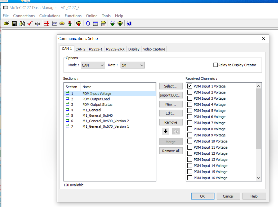

hi,
i have motec m130 and PDM15 plus i have sequential gearbox.
my sequential is configured in the ecu m130 my issue is in the display creator the gear is not changing
in the dash manager communication setup under CAN1 is there a specific setup in need to select from the list
so it can read the gearbox sequential from the ECU
IMAGE and video is attached.

First you need to make sure that no gear channel is supplied by the Calculations->Gear Detection... dialog since you are going to get it from the ECU data stream.
Then you probably need to make sure the "Gear" channel is selected in the M1 0x640 CAN template.
Of course, Gear will need to be transmitted to Display Creator.
And finally, Gear will need to be used in Display Creator.
