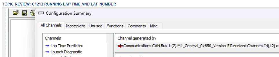

If you go to File | View Configuration Summary, you can see where each channel is generated. and what uses it.

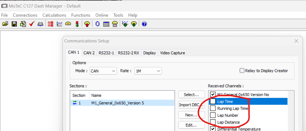

The channels are being generated by the M1_General_0x650_Version 5 CAN receive template, found under the Connections | Communications... | CAN 1 tab.
Channel Generated.png (48.31 KiB) Viewed 9714 times
Untick these channels in the template.
CAN Lap Timing.png (93.27 KiB) Viewed 9714 times
