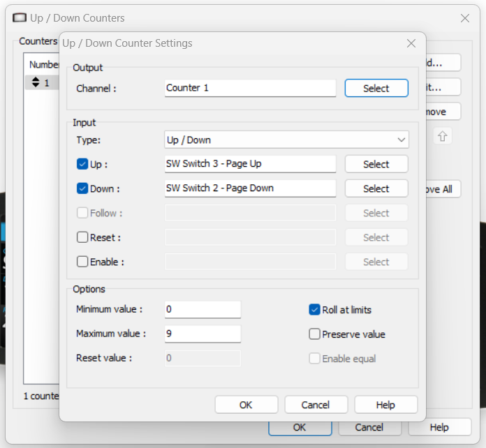

ps. i have 2 can buttons running on GP11 and GP12 for next page and page line.
could you guide me how to setup a counter so or is that needed?
right now the button only displays next page while holding.
Re: Can comms timout
PostPosted: Fri Mar 22, 2024 9:14 am
by Stephen Dean
I use the Up/Down counter function in the dash to create a counter.
Dash counter.png (100.01 KiB) Viewed 10303 times

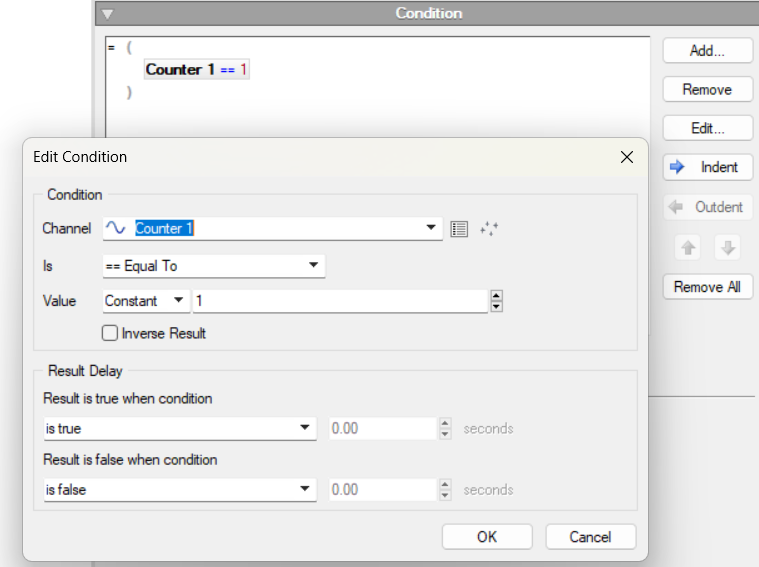

Which is then used to select the page.
DC Counter.png (71.91 KiB) Viewed 10303 times
PostPosted: Sat Mar 23, 2024 8:52 am
by karel021
Worked great thanks :)
