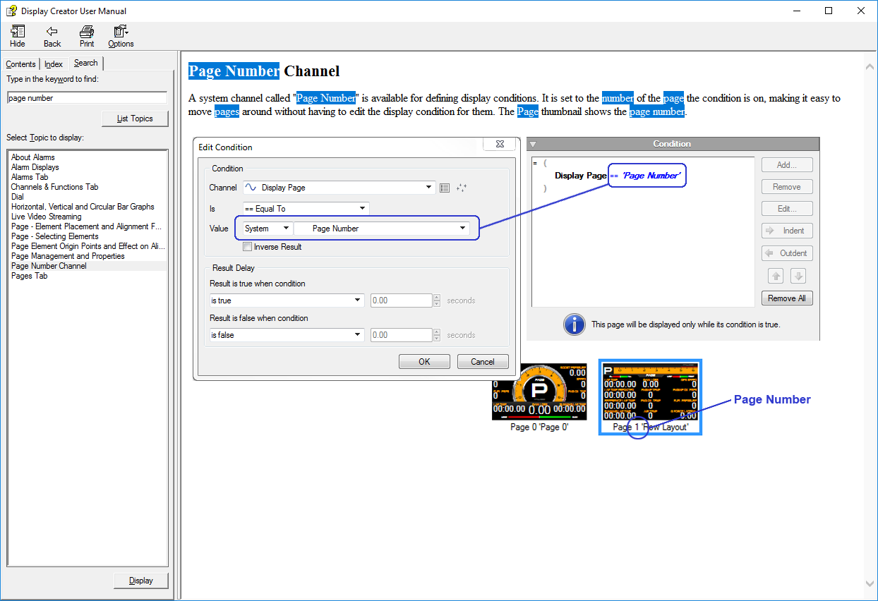

Below is a screenshot from the help that explains how the "Page Number" condition works.
Page Number - DC.png (90.71 KiB) Viewed 25513 times
You don't have to do it that way, you could simply make the display page equal a constant value, the "page number" feature just allows you to move your pages around without having to redo all of your conditions.
