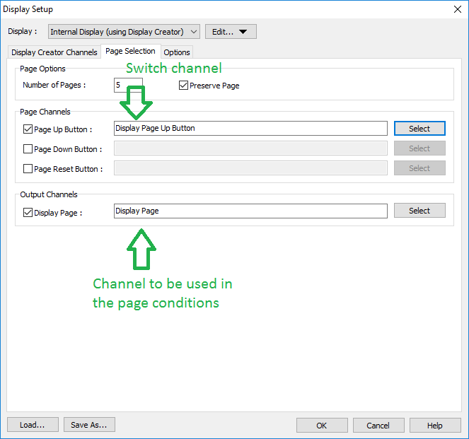

How to i cycle through all pages with one button?
At the moment i have 4 pages

Postby adrian on Fri Apr 07, 2017 10:12 am
The page conditions are setup in the display setup, see below:
DC Display Setup.png (23.2 KiB) Viewed 25537 times
If you have 4 pages set this as the number of pages. Change the "Display Page Up Button" to what ever switch you are using for your page switch. The "Display Page" channel will increment from 0 to 3 every time you press the button.
You then use the "Display Page" channel as the condition for your pages in DC.

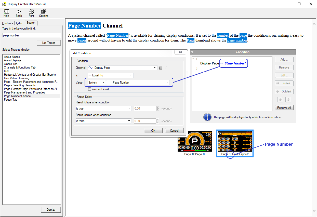

In DC what condions do you use? Page Number or a Constant? Cant seem to figure it out, also makes it harder that the Page1 conditions can't be changed.

Postby adrian on Wed Apr 12, 2017 9:30 am
Below is a screenshot from the help that explains how the "Page Number" condition works.
Page Number - DC.png (90.71 KiB) Viewed 25504 times
You don't have to do it that way, you could simply make the display page equal a constant value, the "page number" feature just allows you to move your pages around without having to redo all of your conditions.
Page 0 has to have no condition so that something is displayed by default if your conditions aren't met. So for example lets say you were able to put a condition on page 0 and you had the following:
Page 0 - Display Page == 0,
Page 1 - Display Page == 1,
Page 2 - Display Page == 2.
If for any reason the "Display Page" channel had a value of 3 what would the Dash display? None of the conditions are met so it would have to be just blank.
This is why the first page has no condition, it is always displayed when none of the other page conditions are met.
