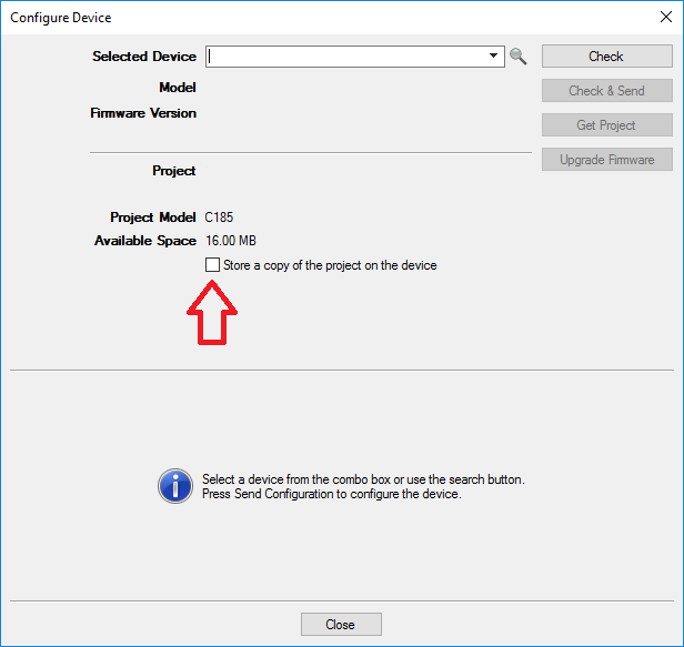

At the moment there is no way of creating a protected DC file that can be distributed, the only way of configuring the DC part of the dash is to send the project via Display Creator. This is something that we are looking at as part of another update but even if this work is done it will not be available until the second half of next year.
The only way you can retrieve a Display Creator project from the Dash is if the person who sent the project ticked the box to store a copy of the project on the device (see below)
DC Config.png (19.1 KiB) Viewed 14720 times
In addition to this, you can set a password in Dash Manager to stop the user from either changing the DC config or, if one was stored, retrieve the project.

Postby the_bluester on Mon Nov 28, 2016 12:19 pm
I suppose at least that answers one of the OP's concerns, if they do not want the customer taking the project and distributing it (For money or otherwise) then simply do not store a copy on the dash.
