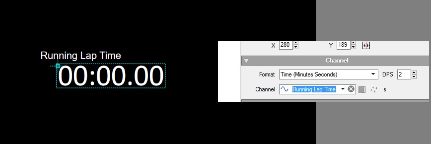

You can setup running lap time as shown below:
The lap time and number setup (In the calculations menu) allows you to setup the lap time channels. The channels are as follows:
Lap Time - Previous lap time
Running Lap Time - Current running lap time
Fastest Lap Time - Fastest lap of the session
Lap Speed - Average speed over the previous lap

Postby FoxSTI on Mon Aug 08, 2016 12:04 pm
thank you for much for your reply.
I had not realize you can select time (min:seconds). That is great !!!
I will look at the maths for the other lap items.
