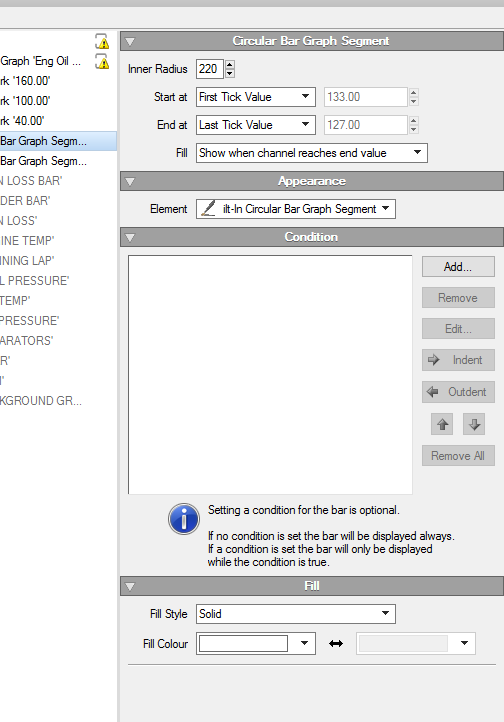

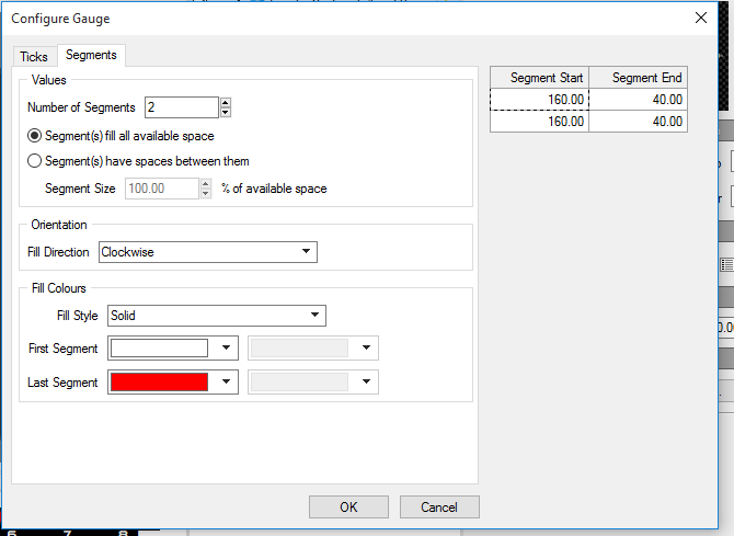

I am trying to create the oil temp/ petrol gauges below but I am struggling; heres my settings
I just cannot get the thin white and red line and thick bar graph used to indicate measurement

How are you testing whether it is working or not? Your "Eng Oil Temp" channel isn't linked to an input so it won't do anything in a dash and you won't be able to adjust the value in simulate mode.

But I think I know what I am missing , SWEEPS , I need to add a serious of Sweeps
That should get me close to what I am trying to do :)
