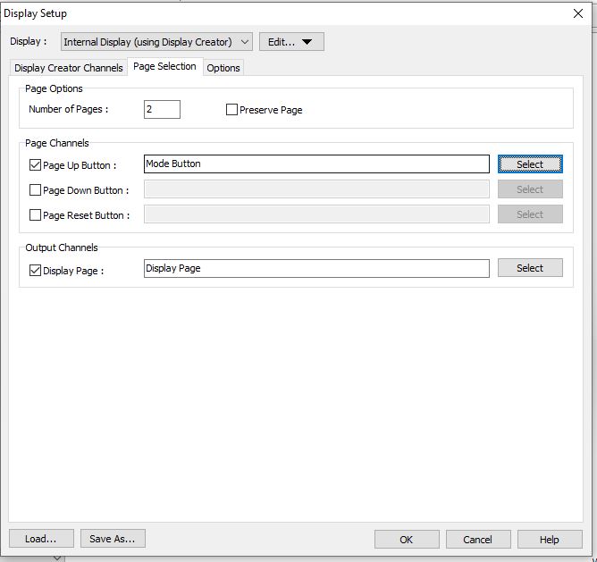

I can see that you have the buttons generating the channels 'Mode Button' and 'Reset Button' and these are included in your channels being transmitted to Display Creator.
I would need to see your DC project to know how you currently have it set up but I would recommend you set up the page selection function in Dash Manager. You can find this under Functions>Display on the Page Selection tab.
You can use this to create a counter with the output channel 'Display Page' transmitted to Display Creator.
In the example image below the 'Mode Button' channel will increment the counter up.
The channel value of Display Page will start at 0 and count up to the maximum entered next to 'Number of Pages:'
display page.JPG (52.35 KiB) Viewed 14806 times

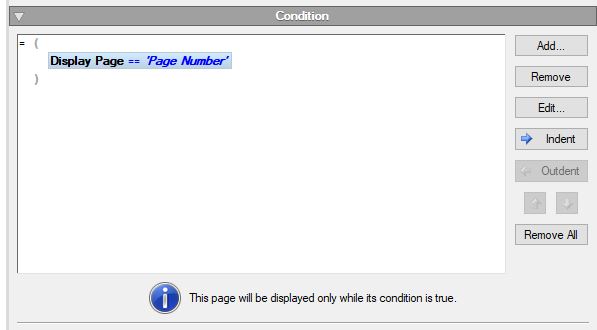

In Display Creator add the condition shown below to all pages except page 0.
Now when you press the mode button the Display Page channel will increment, the value of this channel transmitted to DC will set the displayed page based on the conditions created.
