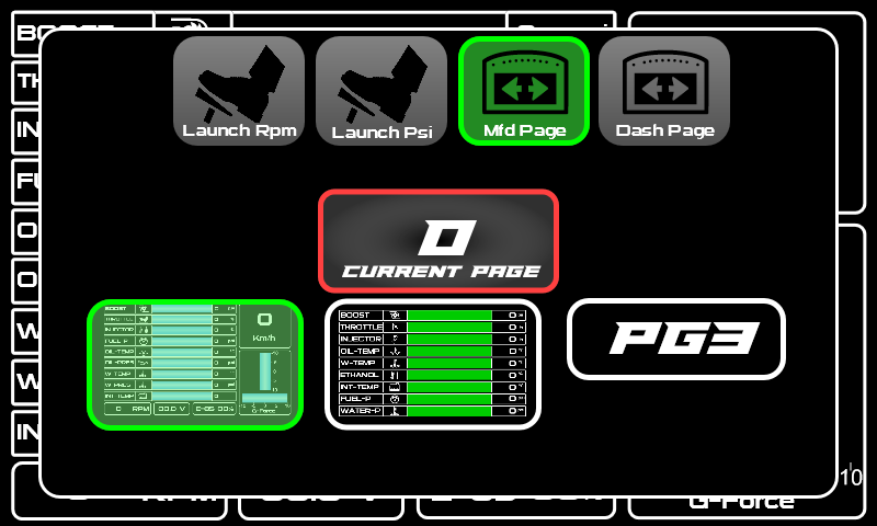

Im currently working on another project and Im using menu's with sub menu's in DC. (screenshot below ignore PG3 its there for a future page)
The sub menu sets the value of the output channel when the item is selected.
This is then transmitted from DC to DM and set as a DM preserved channel the DM preserved channel is then transmitted back to DC to close the loop and update the display page
I prefer the last method as it allows an image to be selected as opposed to just a number so for something like display pages it works alot better IMO.
Menu Example.png (57.94 KiB) Viewed 13403 times
