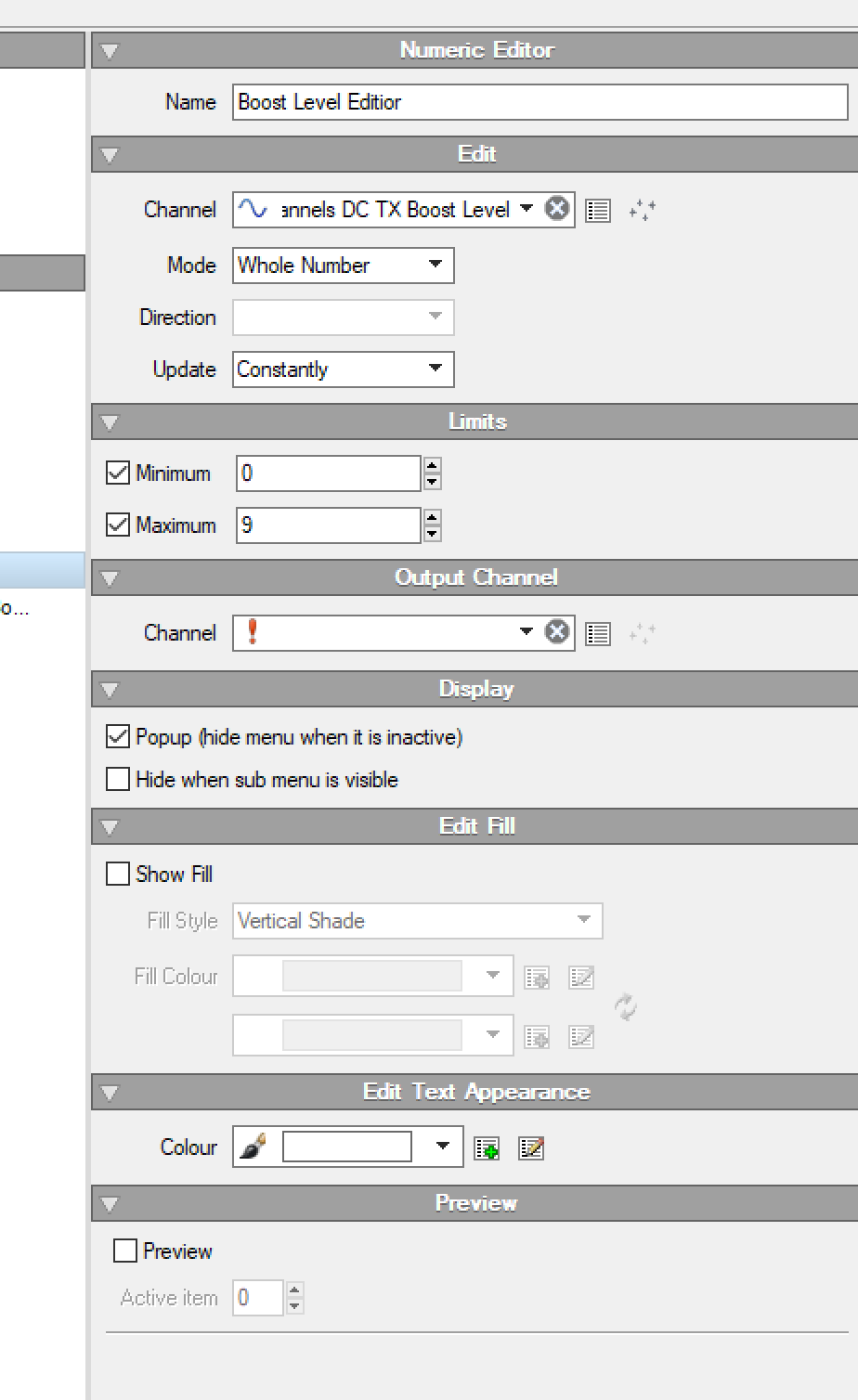

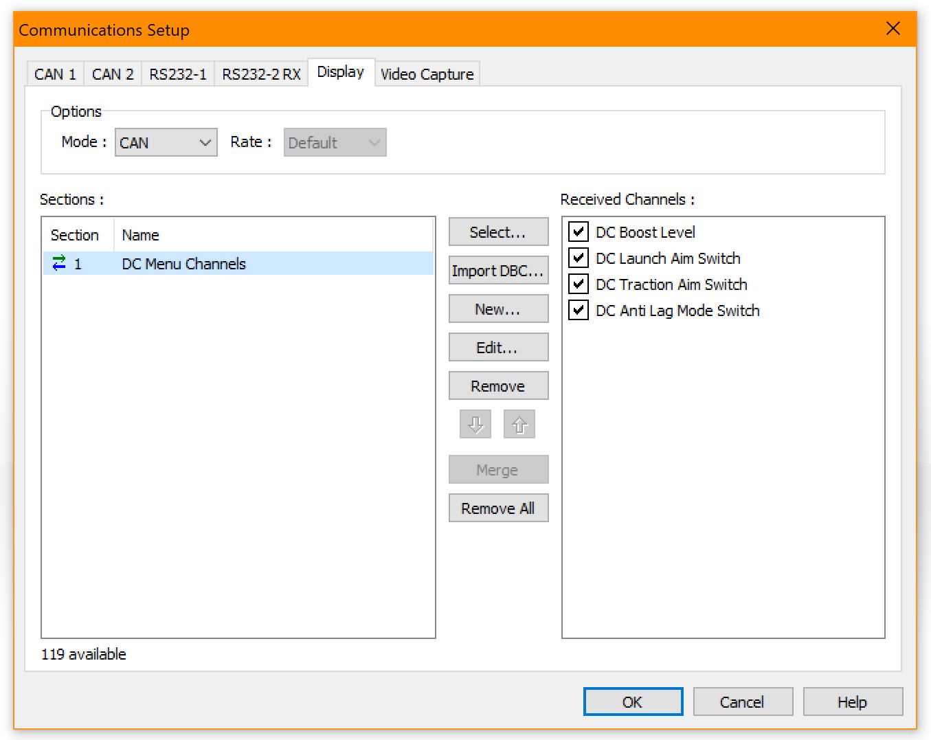

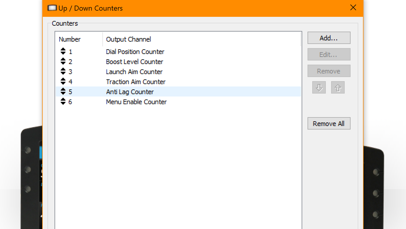

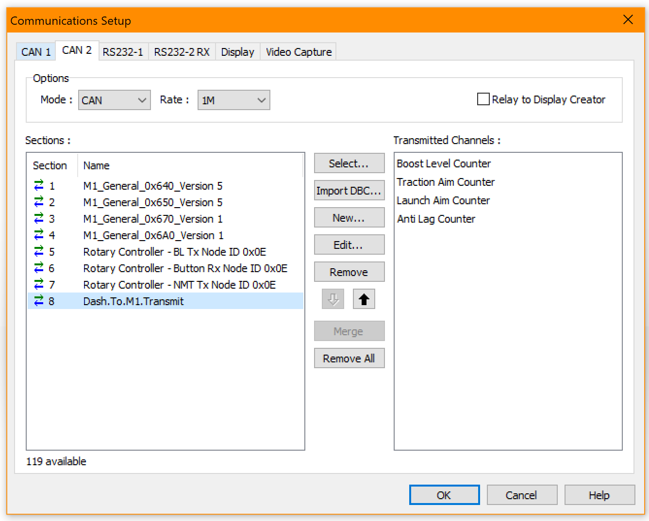

It is quite hard to accurately identify your exact issue without seeing a config, however you will notice that i use my DC channel for the numeric edit, and for tracking in the menu system, which is preserved in the preserve channels setion, however I a transmitting my counter to the M1 (which is also preserved), not the DC channel.
You may have more success adding the additional step.
DM - Transmit to ECU.PNG (58.7 KiB) Viewed 25968 times
DM - Counter.PNG (78.74 KiB) Viewed 25968 times
DM - Menu channels received.PNG (48.85 KiB) Viewed 25968 times
DC - Numeric edit setup.PNG (52.22 KiB) Viewed 25968 times
