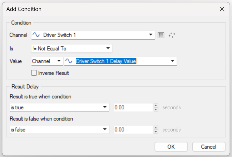

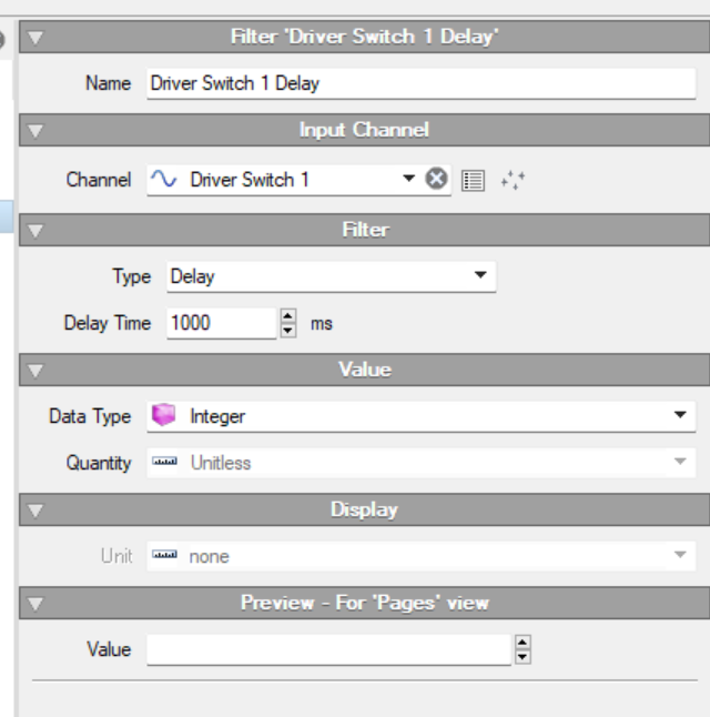

This can be achieved in DC using a delay filter and a global condition.
The delay filter input channel would be the driver switch, the delay time will set how long the global condition is active for. be sure to set the output data type of the filter to integer.
Create a global condition using the != not equal to operator comparing the driver switch and driver switch delay channels, the condition will become true when the unfiltered driver switch changes.

Postby Doorev1200 on Fri Oct 25, 2024 12:58 pm
Well I got it working! Thank you very much. I would have never thought of that way to accomplish this. I probably would have just changed out to a momentary switch to get it working...lol
