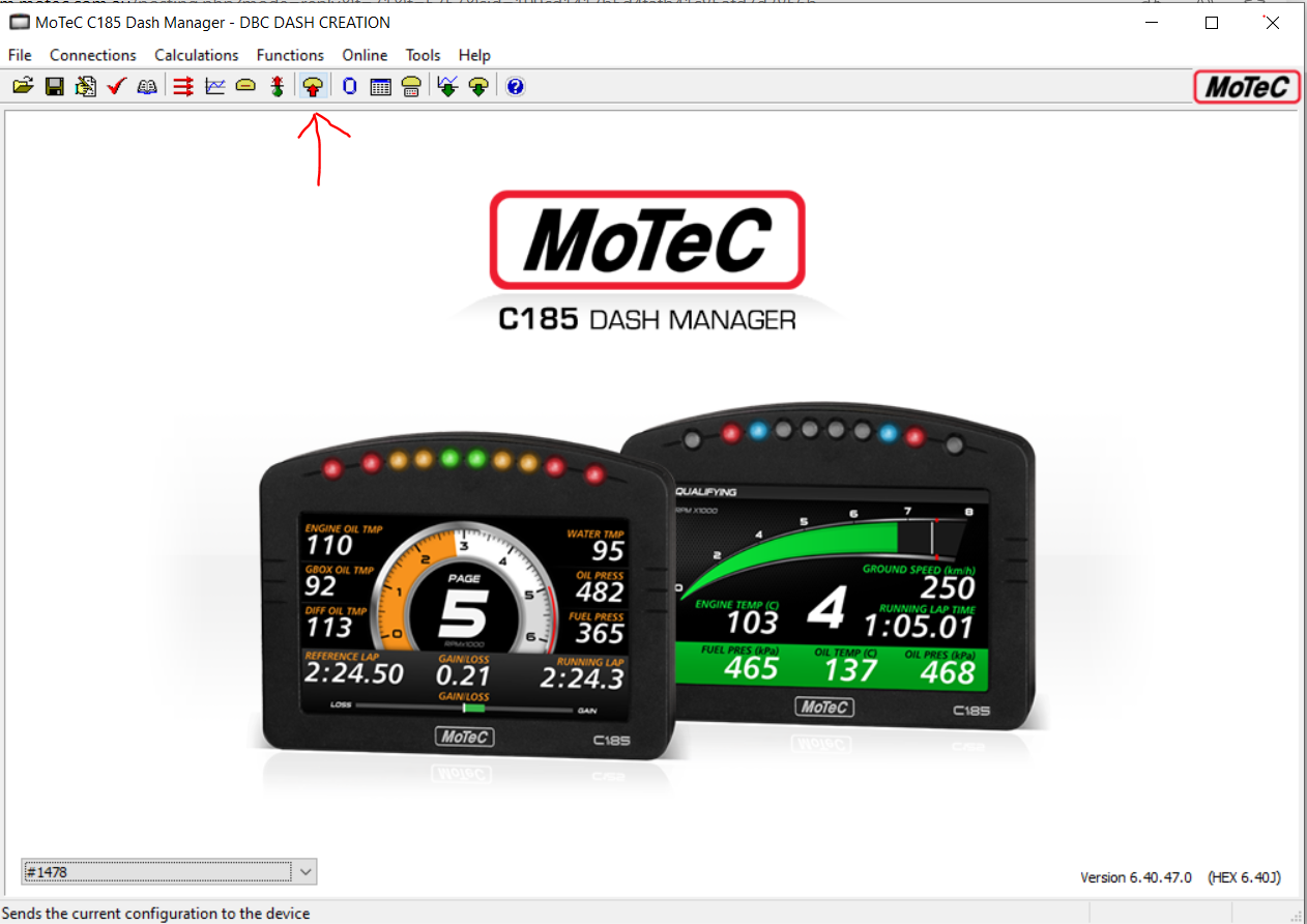

Postby ChrisAkkodis on Fri Aug 23, 2024 7:21 pm
Hey Stephen,
thank you very much for the fast reply. I fixed the problem, I forgot to send the created Dash Manager Configuration. Careless mistake from me, I am sorry guys for wasting your time.
You all doing a great job!
Have a nice one!
Best regards, Chris
Screenshot
Dash Manager - send configuration.PNG (386.62 KiB) Viewed 5654 times
