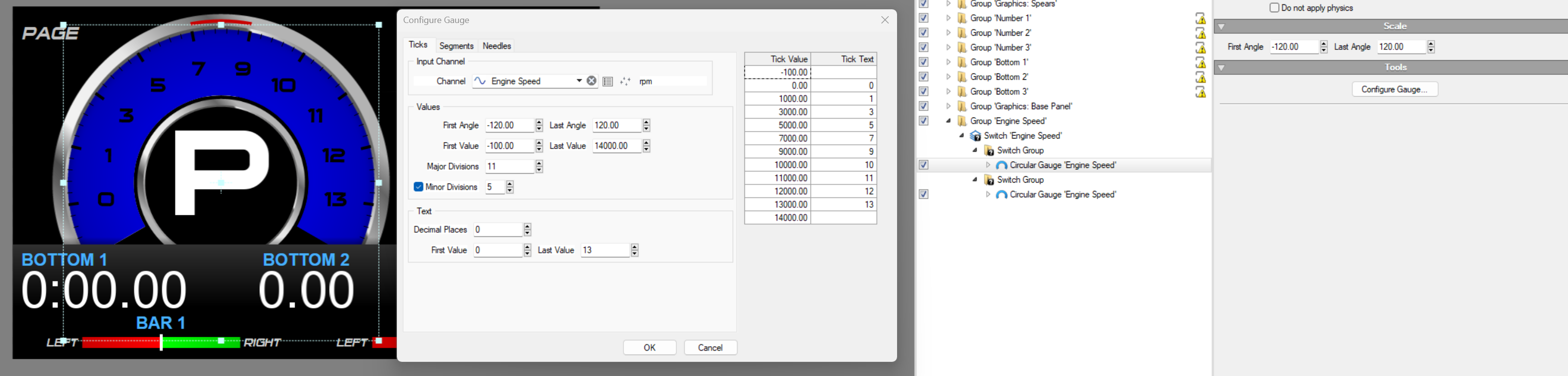

I have watched all of the tutorials available (The tutorial is old and there was mention of a follow up to set these parameters but I could not locate it?) and have played with Display Creator for hours, I can set everything apart from the RPM graph/segments ETC from the STD 8000rpm I am setting up a Triumph 765RS engine which runs to 13000rpm. I also need to set an overspeed and the shift lights on the dash. I also would like to switch the criticals when they are outside of there designated parameters I watched an tutorial from HP Academy and he did this pretty easily using "switch engine temp page" the issue is that he didn't outline how to import these pages or set it up and it is not listed in my Display Creator list for the dash I have configured.

This is a quick config that I did to setup a 13000 rpm tacho display.
Configure Engine Speed.png (515.37 KiB) Viewed 19974 times
The Overspeed/Shiftlights are configured using the Dash Manager, not DC.

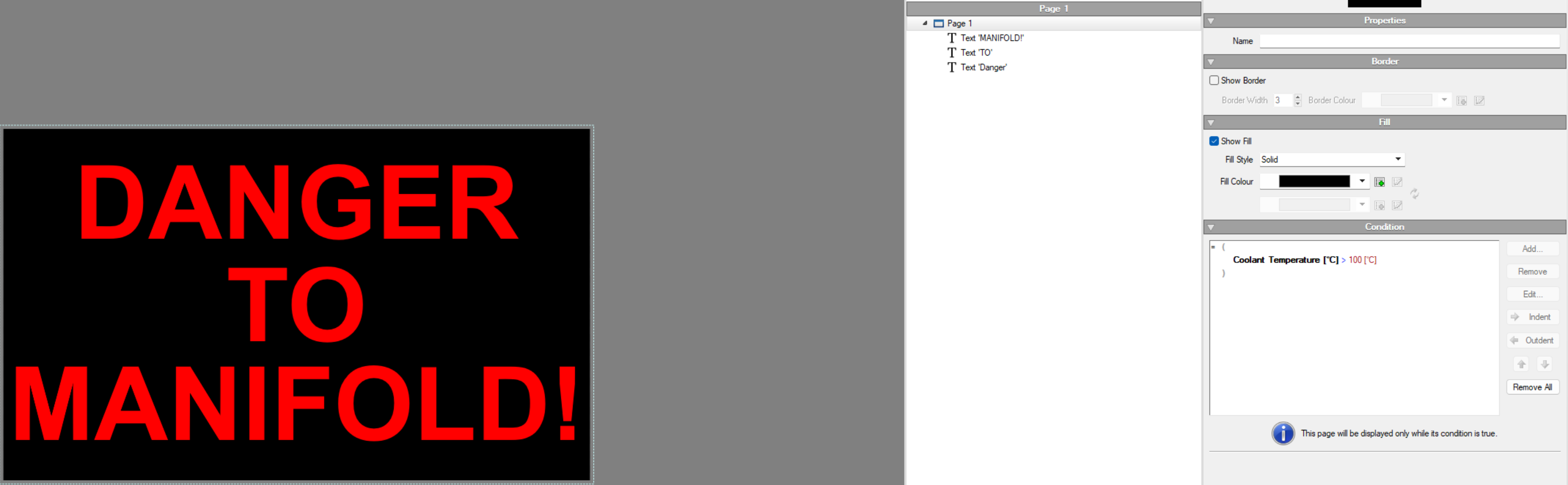

The 'switch engine temp gauge' page is a page that has been created in that specific project, it isn't a base template.
This setup will switch to the new page when the Coolant temp exceeds 100 degrees.
