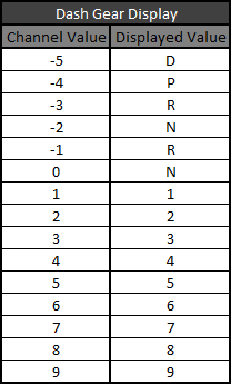

If you were answering my question, I have been trying to do this just in Dash Manager, not in Display creator. I was trying to figure out if I could display R instead of 7 without having to pay for the creator licence, as this is my only current issue with the standard templates.

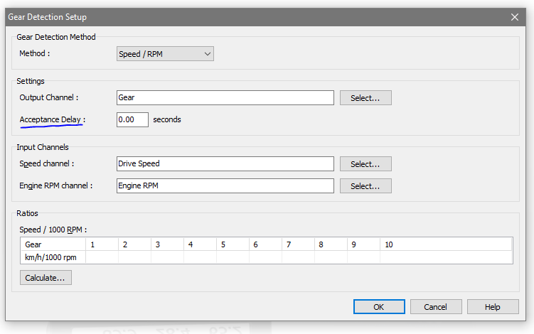

Postby Stephen Dean on Wed Oct 26, 2016 2:22 pm
Under Calculations | Gear Detection

Postby adrian on Wed Oct 26, 2016 2:38 pm
George,
Below is a table of the input values and the displayed values for the gear channel in a standard display setup (ie not using display creator).
You will need to use a 2D table to convert the values you are receiving on CAN to the values needed by the dash to display what you want.
