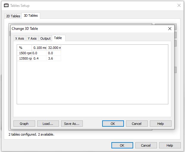

I was not able to get the 3D table to work, and I think it's because the Table values are limited to only 1 decimal point.
For example: 0.1ms @ 1500 RPM = 0.00125
When I try to enter that value into the table, it defaults to 0.0. I've attached a snapshot of that table to illustrate.

If you did want the 3d table to work, then make sure the output units are in % and allow the table to interpolate to get the resolution needed. A quick spreadsheet produced this table that you could use:

Thank you, that worked like a charm.
