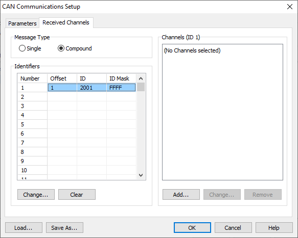

From the screenshot, I'm not sure I understand how to translate the full CAN ID into something to be input into a CAN comms setup. Say you get a CAN ID of "00002001x" from the CAN inspector, how could this fit into a compound receive message? This is what I am picturing with the received message being displayed by a unitless channel, but I don't think the ID is correct:
I apologize for the poor explanations. I am relatively new to CAN and still trying to wrap my head around it.
Thanks for the help!

The addresses 00002001x - 00002007x are 29-bit extended CAN IDs. So for that you would tick the "Extended" radio button under the CAN Settings/Address Format. Then you would enter 2001 (or 2002, 2003, etc for other messages) in the Base Address field. Those do not look like compound messages to me, so just check "single" in the Received Channels tab. Then you just need to add some channels, I would get either 1 or 2 bytes at a time, and initially use the "GP x (0 dps)" (x would be 1-60) channels as place holders until you determine what the actual value is, and how many digits of precision you will need).
