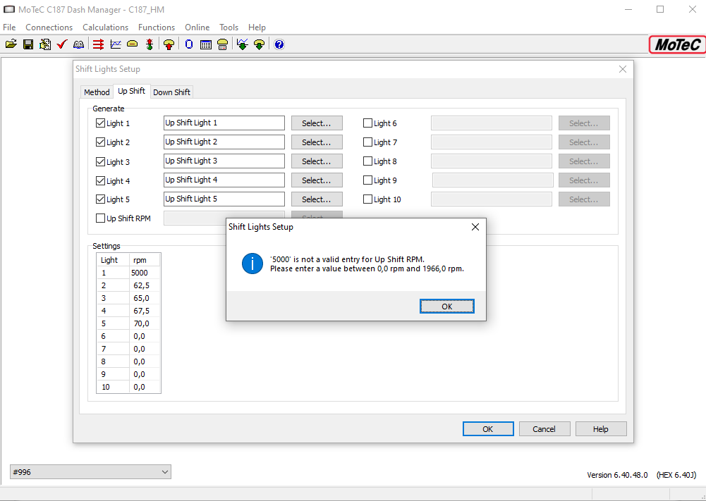

Hello, i want to configure the Shift Lights for a MoTeC C187. The CAN Communication works. But i dont understand why the maximum value for the rpm light set is only 1966,0 (see image). Is there a problem in the .dbc File? I don't know what to try anymore.

What channel do you have selected "Engine RPM channel" under the Method tab?
Does the channel you are trying to use have a base units of hertz (Hz) with resolution of 0.1 Hz. This is what the standard MoTeC RPM channels have -- and i know you are using some kind of other ECU -- perhaps you need to use a table to convert it's units to a Rotational Speed type for the shift lights to work.
Using a MoTeC RPM channel, I get a maximum value of 196600 RPM. I think your value must be scaled differently.
