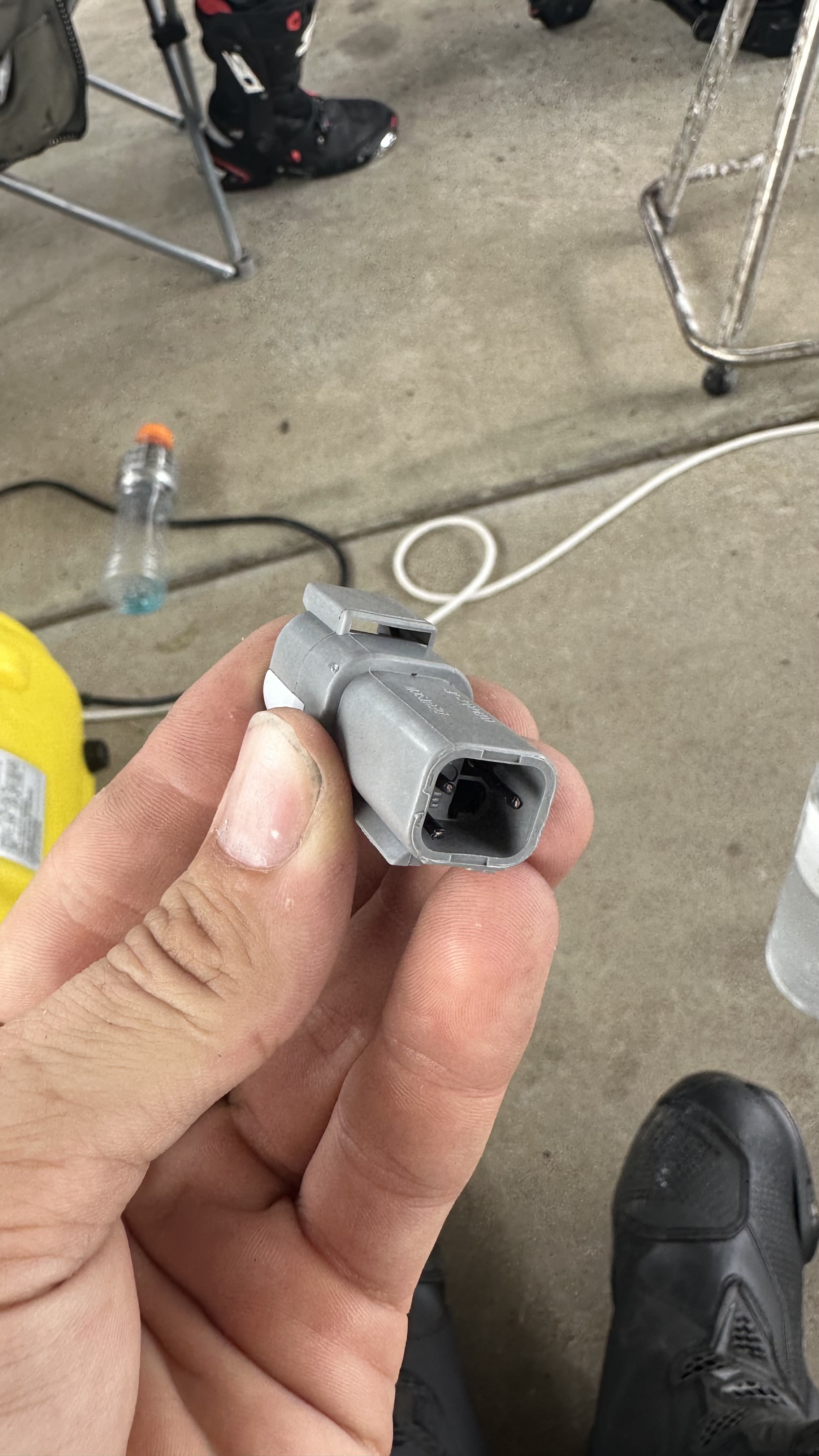

Is there any way to find out which coloured wire goes to which pin on the gps connecter? I tried pulling the heat shrink back and they all snapped
Ben

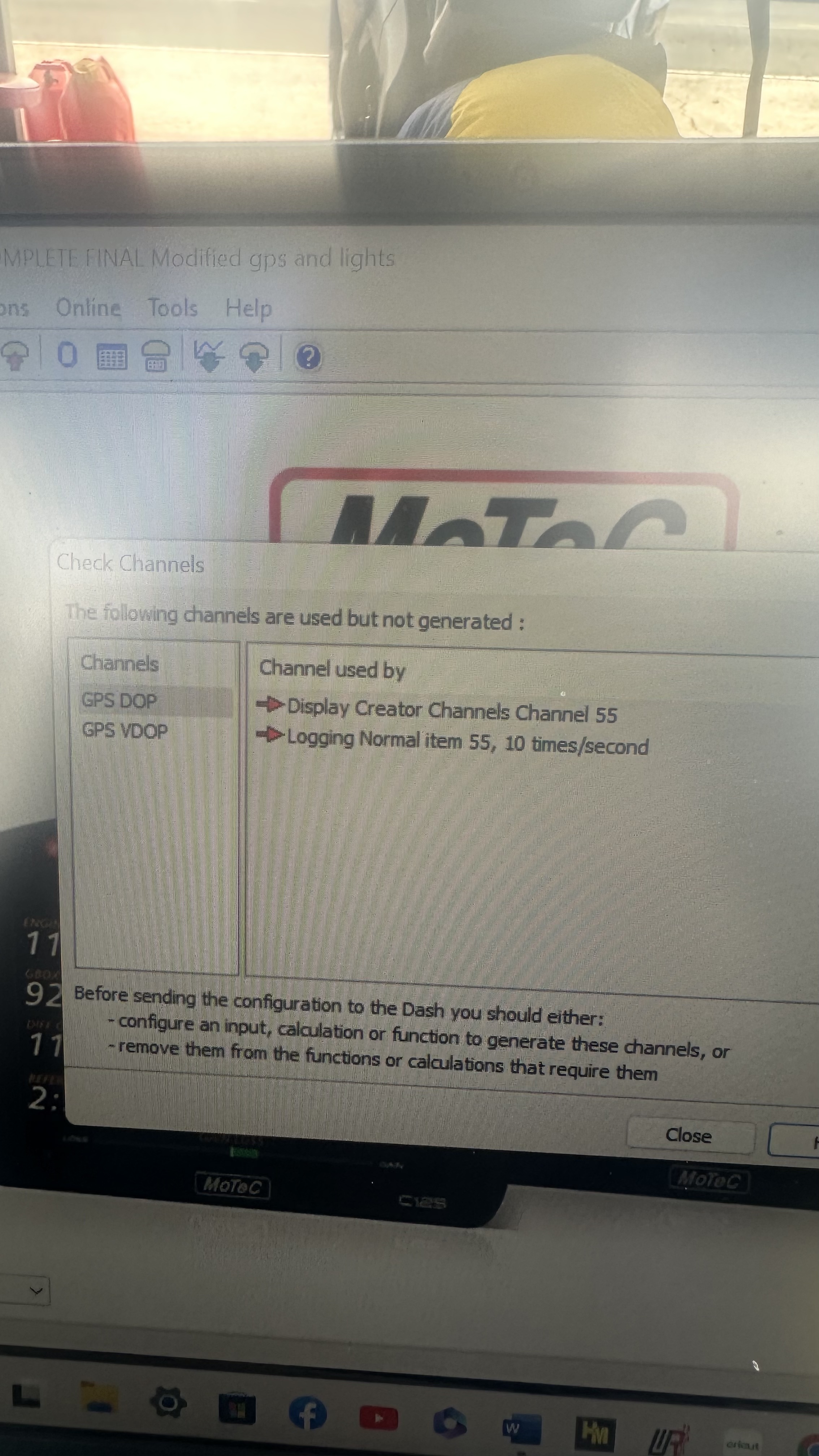

I’ve changed the gps on the dash manager but when I go to send it to the dash I get this message, so I just delete theee channels or do I need to re assign them?
Ben

Did you delete the template out of the RS232-1 parameters first, and then close the Communications window, before adding the GPS template into the RS232-2 section?
Those channels are not needed to be logged or displayed so there is no issue in removing them from there.
