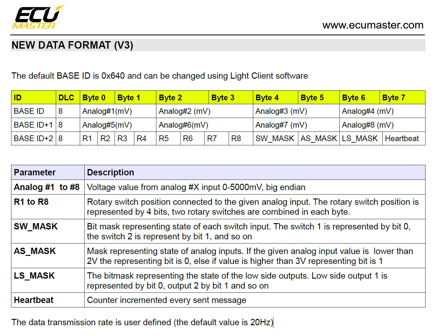

Hi
I am currently working with C1212 dash. I want to use Ecumaster CAN Switchboard (V3.0) for addition input via CAN. Does anyone have Motec dash communication setup file (*.CC9) for this Ecumaster CAN Switchboard.
The information from Ecumaster is in attached file.
Thank you
CAN Switchboard.JPG (287.96 KiB) Viewed 6260 times

That default 0x640 base address will interfere with an M1 ECU -- so you should probably change that.

These files have the base address changed to avoid the 640 clash with M1 and Mx00 messaging, you can change it back if you want or run the Switchboard on the second CAN Bus and share the inputs.

Thank you David Ferguson, Veracity Racing Data and Stephen Dean, MoTeC for very fast reply.
I will change the base address as per recommend to 720.
