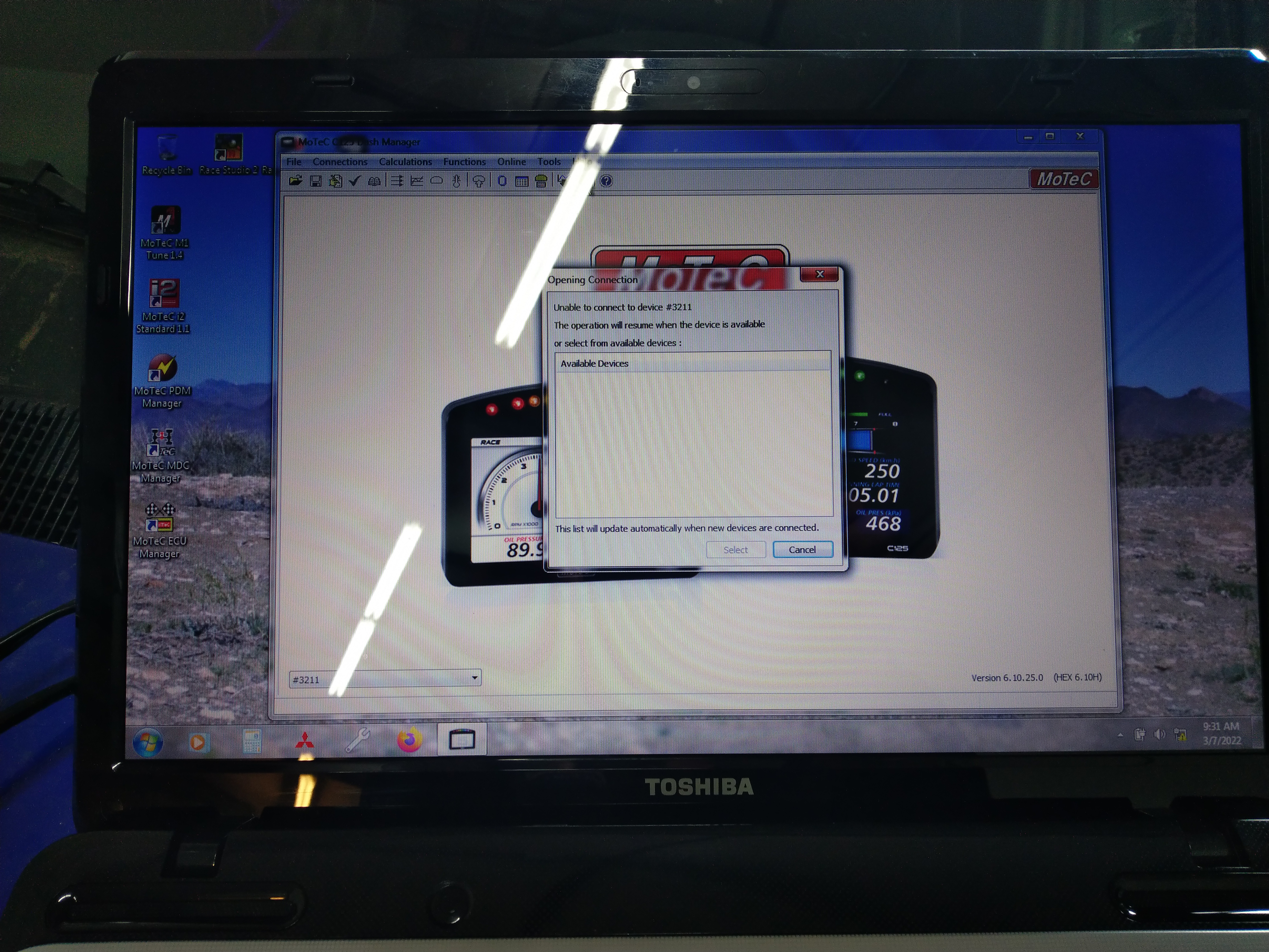

Ok, spent about a hour and half on it today. Dash powers up and says 61.1M on the lower right corner. I install the dash manager c125 610h9 software. It recognizes the dash, shows the serial number, but says its unregistered and is unable to connect.. What gives.. No matter what I try it wont pull the configuration out of it..

Tried again today with two different lap tops, old one win7 pro, newer one win 10 home, using the c125-6.10h software on both. It sees the dash, and says its "unregistered" what ever that means. serial is 3211, and the hex in the lower right is 6.11M when powered up. So I try to connect to it, and it says unavailable... I am at a loss for the time being.. I Put a call out to the old owner of this car for information.. Hoping for a response this week..

The unregistered message is from not registering the Dash in the C125 Manager. If you go to Tools | Connection Settings... in the C125 Dash Manager and click on the Add button the DM will allow you to either search for the Dash, or enter the serial number if known. Click OK once the serial number is entered and then select the Serial Number and click on the Make Active Button, when the Green tick is next to the Serial Number then that is the active dash. Click on OK to go back to the Manager.
