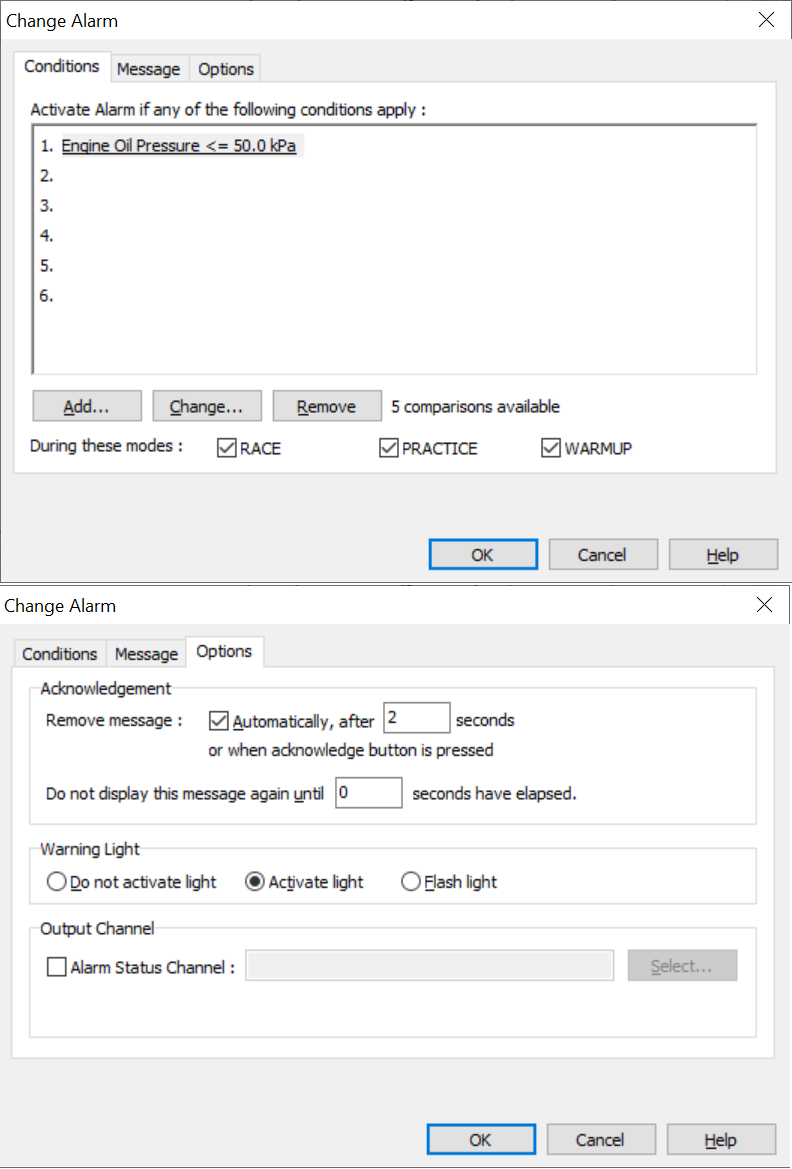

I am trying to get the low oil pressure warning to work just like a Oil Waring light does. Example : IGN on engine not running I want low oil pressure to display and never go away until the engine oil pressure rises when the engine is started . I want it to display low oil pressure for a few second then not if the oil pressure has recovered , just like a oil pressure light would.
I cannot find the settings to make it be like a oil pressure Waring light

To make this work you use the "Auto Acknowledge" function in alarm setup, see below:
Oil Pres Alarm.png (111.74 KiB) Viewed 4830 times

Thank you for that, but still did not work like a oil pressure Waring light. Example if I turn the ignition on and not start the engine I want the warning to be on all the time until the engine was started and got oil pressure. So a added another parameter which was engine Speed <= 300 and now is perfect.
