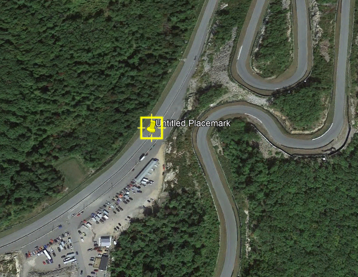

Looking at the logging, the track layout may be causing the issue.
Where the track loops back on itself near the start finish line the logging is creating a new lap in the data. Can you provide the co-ordinates that you used to generate the start finish line?
