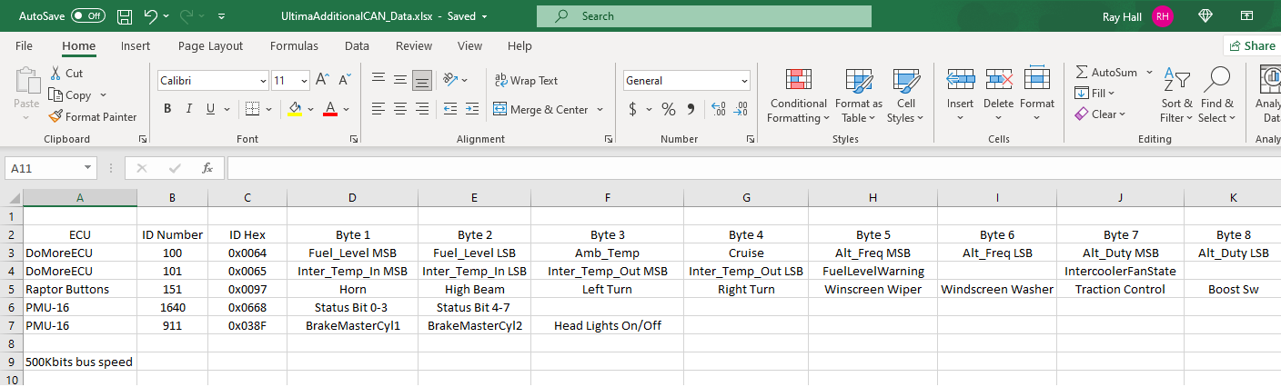

I am going to buy a C127 display. I have been told that I can create new CAN templates for the other devices I made that are on the bus. I only have one CAN bus every thing is connected to this bus and runs a 500kbits . There is a M150 ECU two ECU Master PDM and two small ECU I made. I have tried to create a template, but I find I cannot add the item names and have to select from an existing list in the CAN template creation software. Here is a screen shot of what I want to add as a new template. Another question can I add these to the M1 template to make it easy,

For the channels you've shown (jsut realized I didn't scroll to see them all, but you get the point), I would probably use the existing channels:
Fuel Level
Ambient Temp
Cruise Ctrl Status
Air Temp Icooler In (or Icooler Water T In XX if this is really water temp)
Air Temp Icooler Out
Lights High Beam Status
Indicator Right
Indicator Left
You will have to create channels for your Horn status
