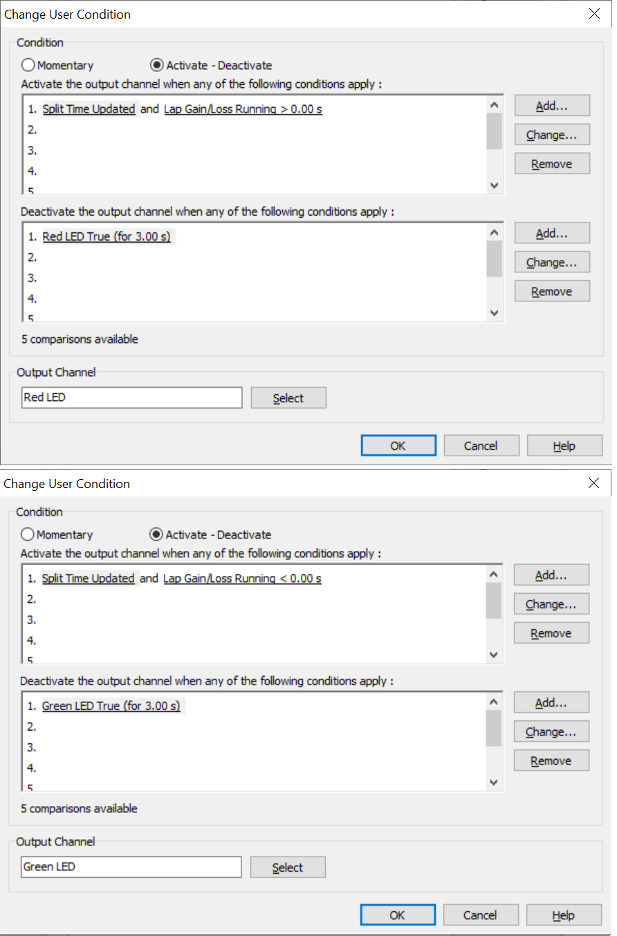

Postby adrian on Mon Mar 22, 2021 1:27 pm
You can simulate laps by adding the 'Beacon' channel to the simulate page. If you are using GPS for your beacon set the ID to 1, otherwise set it to the correct ID. For splits, add another beacon and give it an ID of your main ID + 1.
Below is one way to do the lights (red slower, green faster). The time in the 'deactivate' condition is how long the LED will be on for.
GainLoss LEDs.png (179.56 KiB) Viewed 5696 times

Postby plohl on Mon Mar 22, 2021 3:06 pm
Thanks Adrian, knowing how to simulate laps is going to be very handy!
I didn't even think to use the output channel for deactivation, a lot better than using brake pressure.
cheers
