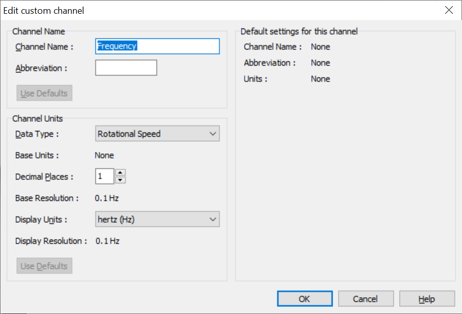

Thanks for the reply and tips. I made some 2d tables with the grips & lever counters as inputs and made 2 more output channels called grips & lever ratio output. Next I assign a aux out, I choose duty cylcle control. Then the duty cycle channel is grip/ lever output ratio channel.
Then i have to assign a channel value for 0% and 100% duty cycle which is 0 for 0 and 100 for 100. But next is freq and the lowest i can go is 23hz. I know you said keep the freq around 1 hz but i cannot do so. Do I have this set up correct?

That is interesting, I thought you could set that lower, I'll raise it in our system.
To get around this for now, create a frequency channel in the constant setup (Calculations>Constants) and set it to 0.
Then change the output type to "Duty Cycle and Frequency Control", set 0-0Hz 1000-1000Hz in the frequency setup and select your frequency channel. Use your duty cycle setup as before.
This will run at 2Hz which is the lowest you can go.
