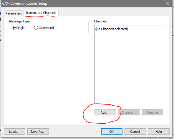

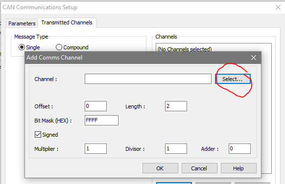

Hi! Thank you for your response. I alreaddy read document you sent to me But I still with job not done. At the page 4 of that document Appear menue box called (Change Comms Channel) I can`t find that menu box in my screan. You talk also to use the (Add ...button) I dont see that button in my screen And I dont see picture of it in your document too. I need dodument talking more step by step to making that job done. I hope you can help me more on that subject Thank you.
Giardbusa
Posts: 18
Joined: Thu Nov 28, 2019 2:33 pm
Re: C125 dash pressure sensor
Postby Stephen Dean on Wed Dec 04, 2019 11:53 am
It looks like I'm going to have to redo that document as the primary and backup copies that I have are both corrupted.
The Add button is found on the Transmitted Channels tab.

And the Select (or change if an existing channel is in place) is in the Add Comms Channel popup window.
