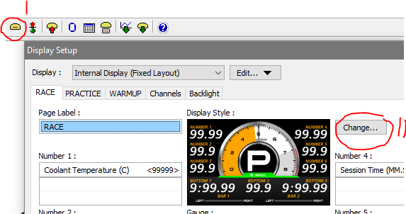

Do you have any images of the standard templates

If you download any of the C series Dash Managers, and go to the Display Setup window (I), and click on the Change... button (II), you can see the list of display layouts available.
Display Setup.PNG (35.56 KiB) Viewed 10982 times
