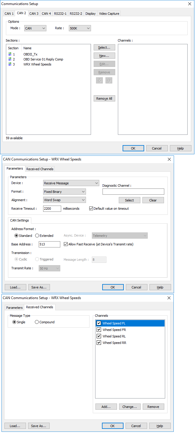

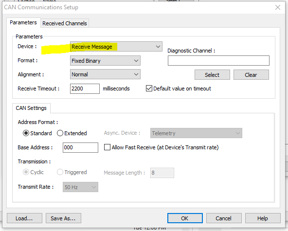

Postby FoxSTI on Thu Apr 12, 2018 3:30 pm
Is this what you mean in your example?
Adrian, I know this may be too much to ask, but do you have a setup the in CAN based for any car that I can look at as an example? I would go along way.

Postby adrian on Thu Apr 12, 2018 5:11 pm
Yes that is correct. You would use a receive message template for all of the channels you are receiving directly from the CAN.
Below is an image showing the setup of a Dash that uses OBD for most of the channels but also gets Wheel Speeds directly from the CAN bus.
