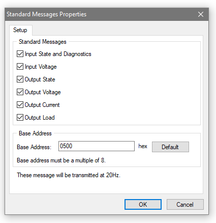

Can you check that the PDM is setup to transmit the standard messages correctly.
PDM Standard messages.PNG (12.77 KiB) Viewed 12748 times
A 512 message is saying that the device is not receiving any data on the address specified.
Are there any other devices on the CAN Bus? Is it on the correct bus?
