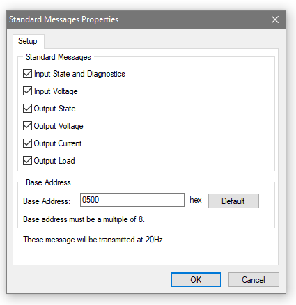

Postby Stephen Dean on Wed Sep 06, 2017 12:23 pm
Can you check that the PDM is setup to transmit the standard messages correctly.
PDM Standard messages.PNG (12.77 KiB) Viewed 12746 times
A 512 message is saying that the device is not receiving any data on the address specified.
Are there any other devices on the CAN Bus? Is it on the correct bus?

Postby 52pickup on Wed Sep 06, 2017 12:27 pm
Yes. Tried with just the wanted data checked, I've tried with all of it checked, I've tried different types of data to receive. Additionally, I'm running two PDMs and I'm having the same issue with both, but only on standard messages.

Postby adrian on Wed Sep 06, 2017 1:15 pm
What address do you have the standard messages set to and does this match the dash? By default this should be 0x500 in the PDM and the PDM receive templates in the dash so will only be an issue if you have changed something.
The other thing is if you have two PDM's on the same CAN bus and don't change the address on one of them it will cause bus errors. The second PDM should be set to 0x510 if you want it to match the PDM 2 templates in the dash.
