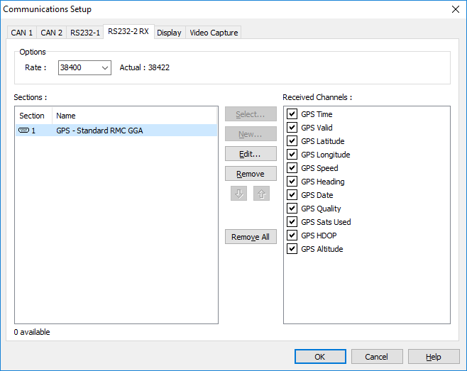

Hi everyone. I've got a C125 Track kit. I can't for the life of me find the information on how to setup the included GPS receiver in the Dash Manager. I know you have to set it up as an RS232 device but that's about it.

Found the manual for the L10 receiver. Doesn't have any details for setup specific to the C125 but the ADL/CDL settings look pretty much the same. There are 2 different RS232 options on the C125 though which isn't mentioned. I'll try each and see how I go.

If you go File>New and then select one of the ECU's it will have the GPS/buttons etc already configured to match the track kit. Otherwise simply setup the GPS in RS232-2 by selecting the GPS Template as per below:
GPS Setup.png (14.26 KiB) Viewed 9832 times
