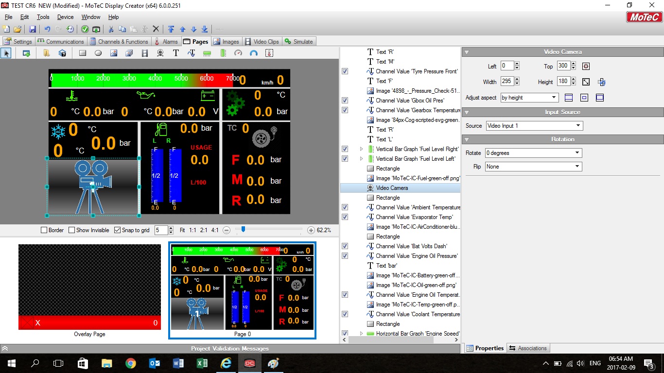

Im using Display Creator,and set it up for Video input 1. Do you have to do it in dash manager aswell?

It is a little bit hard to tell from just a screenshot, but from what I can see that should just work. What sort of camera are you using? Is it sending out a composite video signal?
