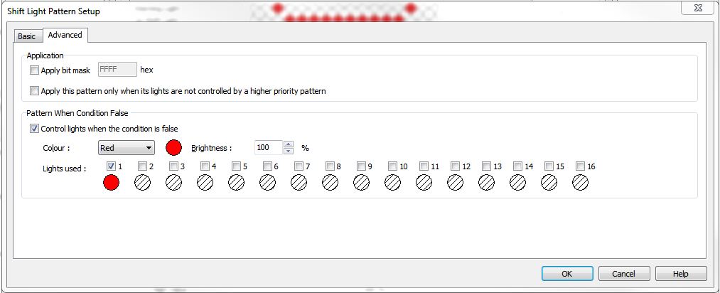

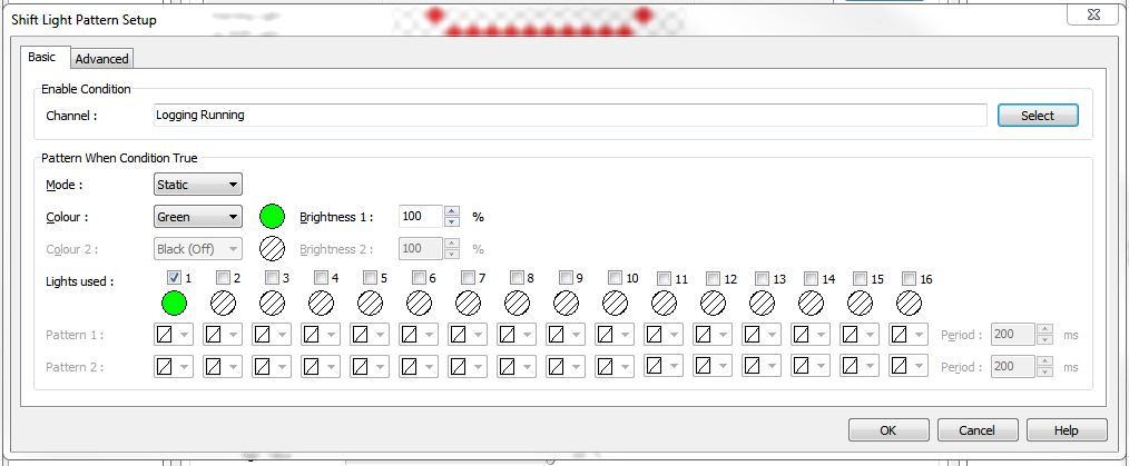

You could also give this a try using the status lights on the side of the dash.
C127 Logging running.JPG (77.88 KiB) Viewed 21464 times
C127 Logging stopped.JPG (61.85 KiB) Viewed 21464 times
I don't have a C127 available at the moment to test this, but I can't see why it would not work.
