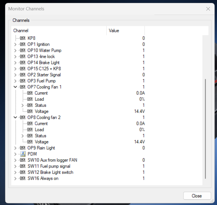

Running the PDM config here on the bench, the fans turn on. As there are no retries configured in the package and the outputs are in effect staged, there is every chance the PDM tried, over current triggered and went into fault.
You would have to check the status of the channel in monitor channels to determine this:
Shortcar Monitor Channels.png (117.52 KiB) Viewed 3352 times

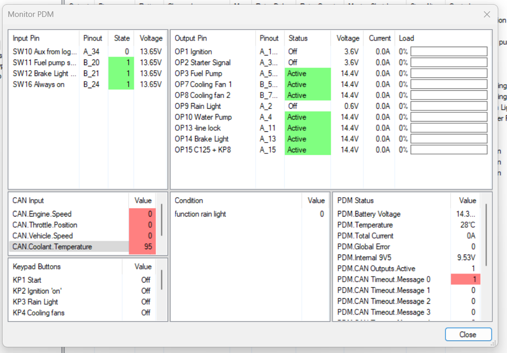

Postby Stian_M on Mon Aug 26, 2024 5:13 pm
I have configured both fan outputs to on: 90 and off: 85 degrees.
And its Running when i use the keypad button.
It also says 99 degrees on the can input monitoring (just simulating on the c125. Engine not actually running. Hope thats not a problem? )
