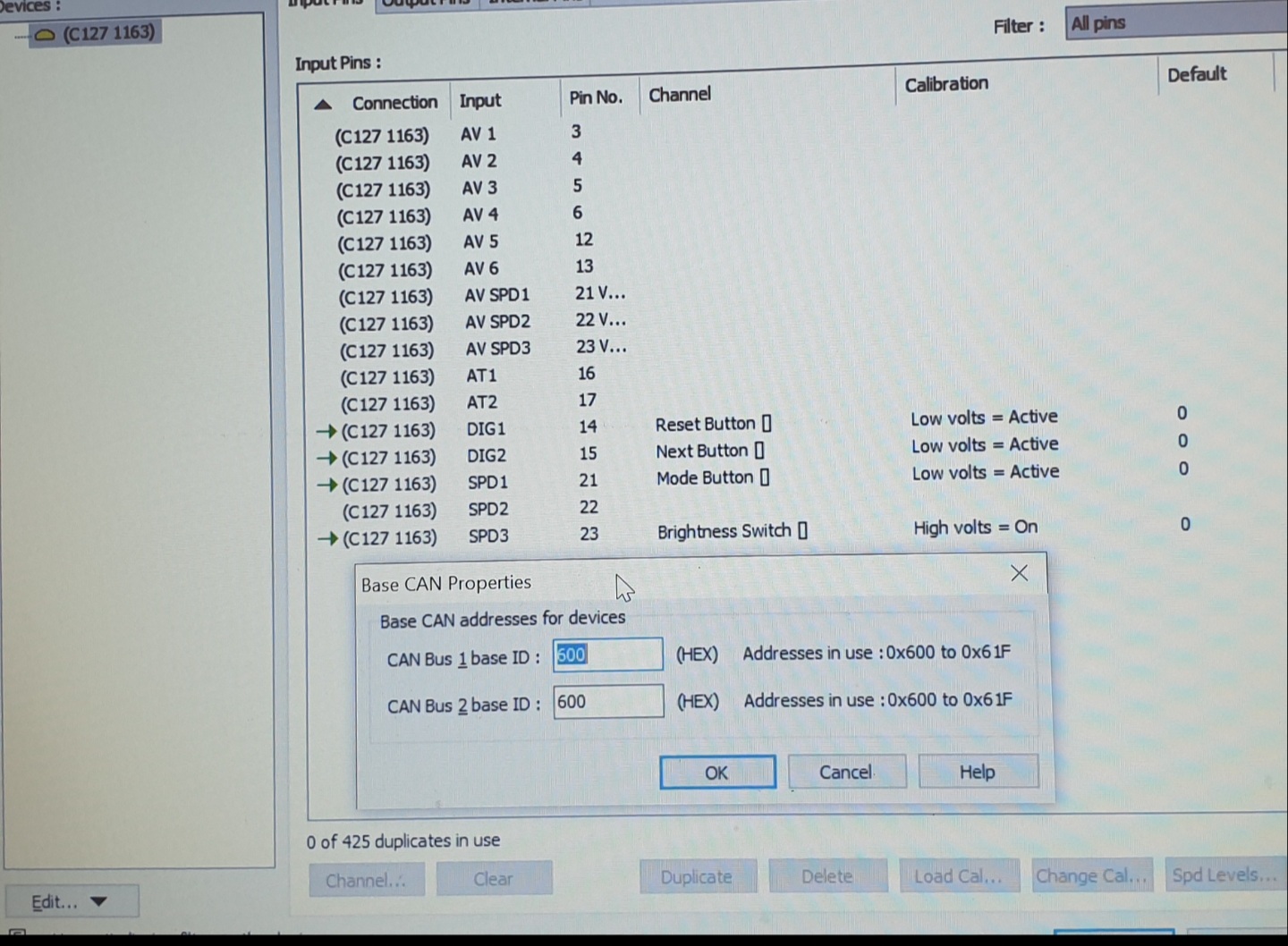

Hi Adrian
Just wanted to confirm if this was the menu you were referring to and if so which setting I should be changing and what I change it to.
Maybe it would be easier to just change the CAN address I am using for my custom data set

Yes that is correct, just change both of those numbers so they don't conflict with addresses you are using. There is a range used from the base address you select to base address + 0x1F.
