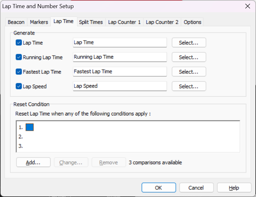

The tracks of my racing cars are all closed-loop tracks. I want to set the lap time in my C125. I plan to use the starting latitude and longitude as the reset marker for setting the time for a single lap. How should I do it?

Go under the beacon tab and select Beacon Type: GPS
Then make sure your venues all have GPS coordinates in them.
That will generate lap times every time you cross the indicated start/finish
The reset conditions are for conditions where you might not cross the start/finish line. Such as you come into the pits, or spin off course and have to restart. So you might have conditions when the speed is 0 for some length of time.
My reset conditions has only "Session Reset True"
