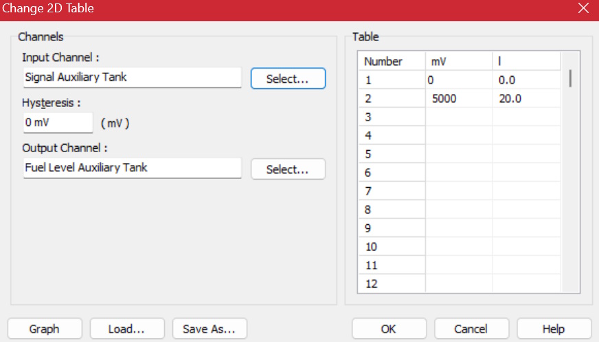

My first problem is I created a simple 2D table to get fuel level for an auxiliary tank, based on a 0-5000mV signal. To test it, I simply did a 2D table with 0mV as 0l and 5000mV as 20l. For some reason though, in simulation mode, when I adjusted the analog signal, the fuel level did not change. "Fuel Level Auxiliary Tank" has the exact same channel properties as "Fuel Level" as transmitted by the M1.
Test 2D Table Settings
2D Table.jpg (75.85 KiB) Viewed 386 times

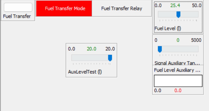

Now, here is the simulation screen. I can change fuel levels, turn transfer mode on and off, and I can see the levels changing on the dash, but for some reason, the relay channel never goes true (it's an On/Off Channel).
I have tested another user condition which switches a channel on and off based on RPM and oil pressure and that's working perfectly too. For some reason I just can't get this fuel level thing working. I figure that because both the 2D table and the user conditions aren't working, perhaps there's something wrong with the way the channel is set up, but it appears to be fine.
Simulation Screen

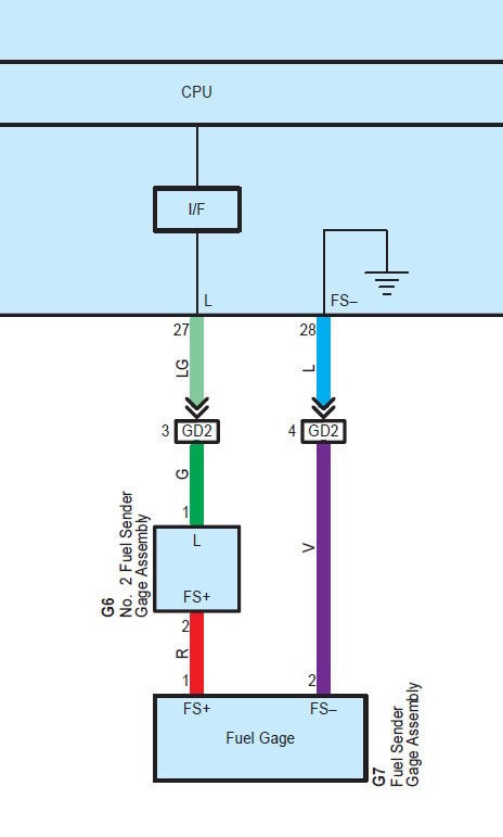

One more question. This is for a Toyota 86, running an M1 with the latest version of the 86 package. I hven't actually tested it yet, but is the fuel level for the main tank broadcast on the M1 general template? I know the sender itself is wired into the instrument cluster CPU however didn't know if this was broadcast on the OEM CAN and then the M1 was picking this up and broadcasting it. I was hoping to get fuel level from the main tank without needing to hack into the sender wiring.

1. Using a 2D table to translate voltage to a tank level is a bit weird in the first place, why not just directly generate the tank level from the input? you can duplicate inputs if you want to have the raw voltage and the translated fuel tank level as channel values.
In any case I tested this and couldn't replicate the behaviour, if you simulate the value of the input channel of the 2D table then the output channel value will change accordingly.

3. In the Toyota 86 the fuel level sensors aren't wired to the ECU or received as a CAN signal. All OE CAN signals available as firmware resources are defined in the Toyota 86 group help e.g wheel speed sensors.

I wasn't sure how to set up the analog input to translate directly to tank level, as 0 isn't 0mV and full isn't 5000mV - these are just values I used for testing. So I create a table with whatever the mV is when the tank is empty against 0L and whatever the mV is when the tank is full against 20L. That way the dash can interpolate the values in between.
Regardless, I got it all working and to be honest I don't actually know how - I just deleted my user condition and re-made it exactly the same way, but it worked the next time I tried it. Possibly a bug somewhere?
